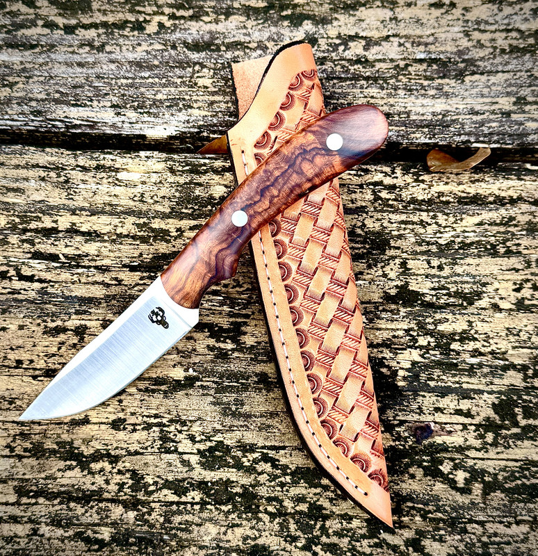

My photo studio is an antelope hide tossed over a trash can behind the shop. Literally a trash can. It's in the right kind of shade till bout noon. Morning pics at this locale are better. It's in the shade in the late afternoon too but the light is different. Morning is best for me. My photo studio:
I use a mane hair hand twisted rope called a mecate to hold knives in place and to give it a lil angle for the pic.
For me a camera (Canon DSLR with a Canon 18-135 lens) does a better job on the knife pics. I've found that my phone handles tricky lighting situations better but the camera handles perspective, depth of field etc a lil better. A phone pic late at night inside the house:

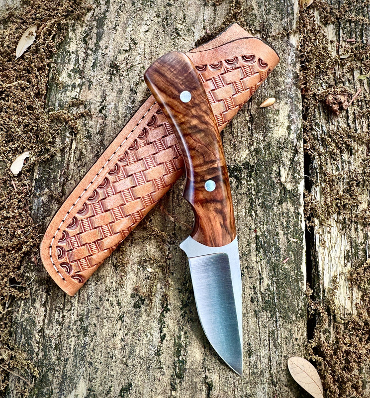

Outside evening light with nature as a backstop.
