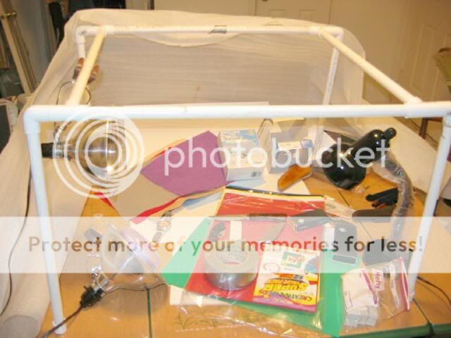

Here's my light box/tent.
Got the idea from Mistakeroo's post above :) THIS SITE
I made the frame bigger overall.
Mine is 31x26.5x19high. I'll probably reduce the width and depth a bit.
I press fit everything as I don't see a need to glue it. Easily disassembled
Lighting is cheapo reflectors, Reveal 120w daylight bulbs,. Craft store has inexpensive felt material, 12x8 and foam placemat sized things that are great backdrops also. I also use floor tiles as backdrops.
The gauzy stuff is packing material to diffuse the light if I wish.
AND moldable, non hardening clay to prop up the exhibits to the angle I want.
