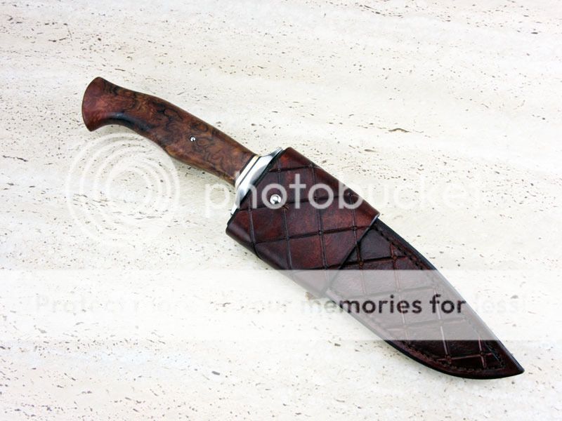

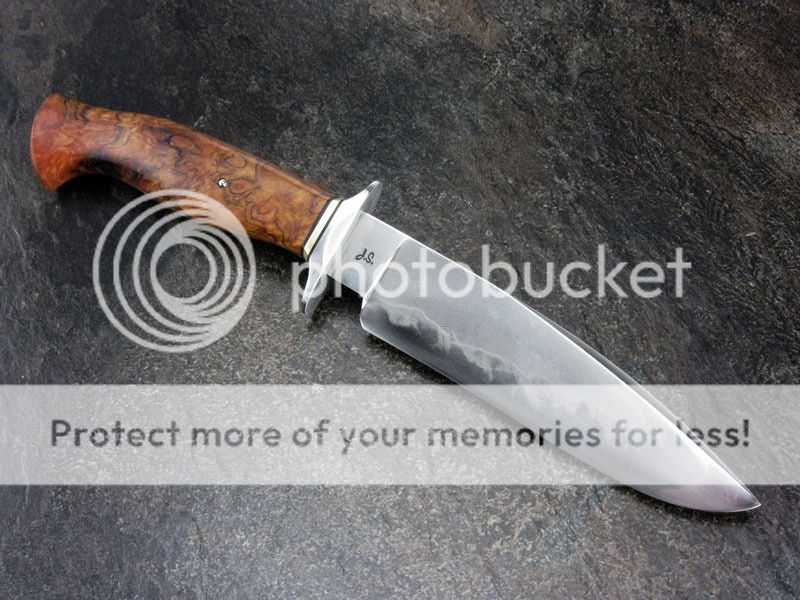

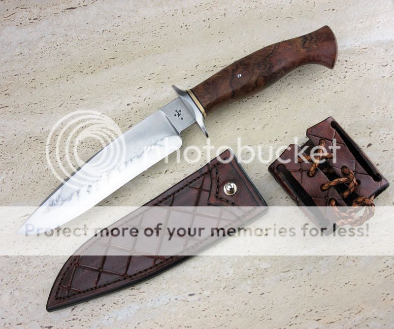

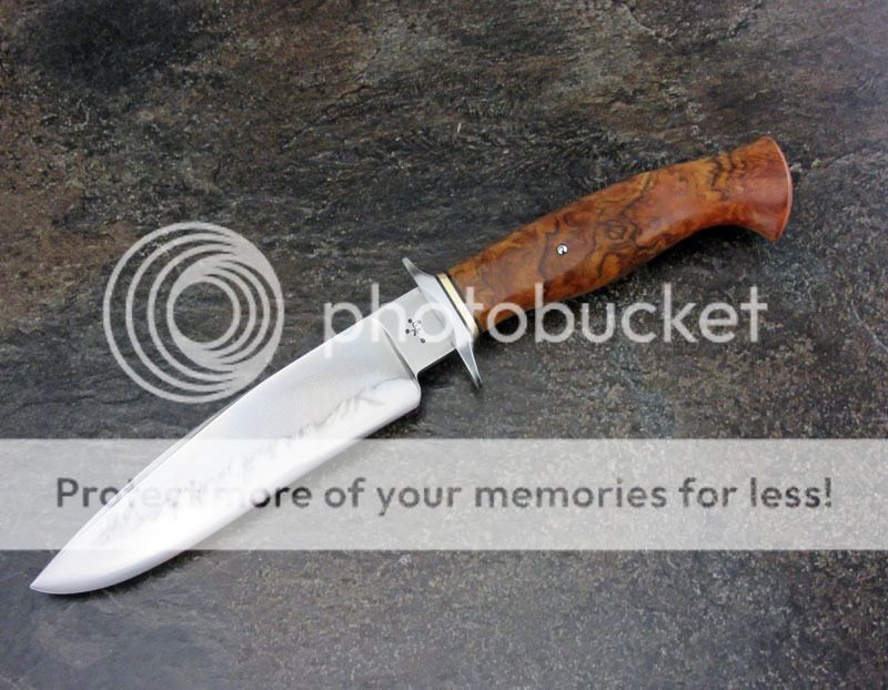

A little experimentation, I added some ground scale in with the clay on this one to try and retard the quench. I am very happy with the results :). There is a lot happening in the hamon and some very groovy bainite banding going on that I just cant capture with the lense :(.
Specs : BL 5 1/2", 140mm. OAL 11", 280mm. Forged W2 with Hamon. Flat ground with a convex edge. Weighing in at 6 1/2 oz, 200 grms. Fast in the hand and the balance is spot on. Clip is sharp for 1 1/2", 38mm. Stainless sculptured guard with G10 and bronze spacers. Stabilised Coolibah burl handle. Tooled leather sheath with frog that allows traditional and cross carry.
Thanks for looking and comments welcome. Also posted in the for sale section.
Cheers Keith

Thanks Gary. Like I said, lots going on there. Wish we had a Coop or Royer down here to do it some justice :D

2nd photo looks like a bank of clouds. Very cool!

I can't believe it took this long for comments. I would change the butt drop of the handle but other than that I do like the profile. Come on guys, this is one of Keith's best.
Come on guys, this is one of Keith's best. I might change the handle butt drop but other than that it is what I like. Am I wrong? I don't know why it took so long for others to respond. Sorry for the rant. But!!!
Thanks Gary for your comments mate, I appreciate it a lot. Is the drop to much do you reckon? I must say it feels real good in the hand imo :)

Keith, Mate that is one gorgeous hamon on that blade. I assume that the rest looks like the second picture?
