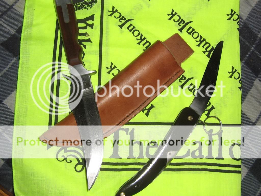

My apologies for the bad picture, it is the only one I have of this knife at the moment. The okapi in the picture was rehandled by me with aluminum breaker bars and 3/16 brass pivot screws. I removed the rust from the blade and later repainted this.
The blade was done with 1000grit wet/dry. It had very light pitting on the blade as well. Let me know ~ I can tell you step by step how-to-do for your knives. Refinishing your knife if something I would do for you but I would like to see pictures of the knife before I say yes. If it is an expensive knife, changing the finish on the blade MAY ruin the collector value of your knife.. Satin finish wouldn't be hard to do. 1000grit wet/dry and flitz polish. These are bad pictures. Let me know.
