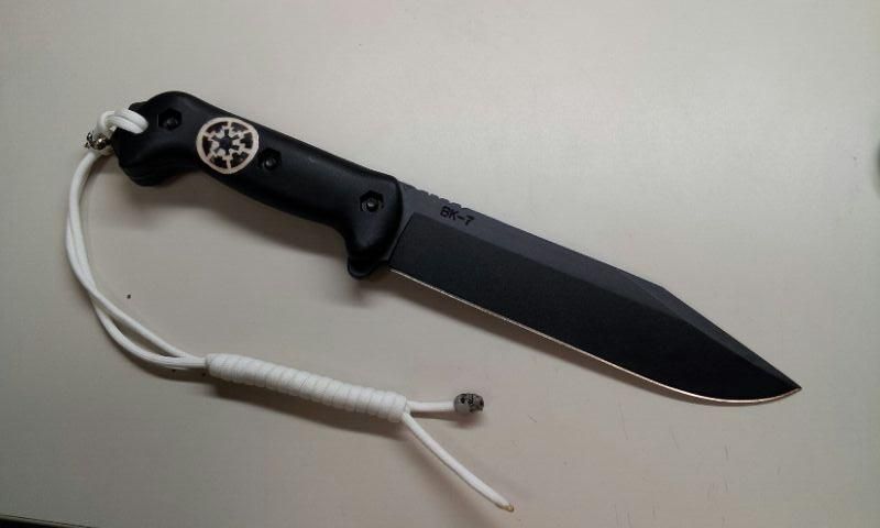

well I had decided already not to do a kydex since the stock sheath is pretty decent. Ka-Bar has stepped up a notch in the construction of the new ones (I'm guessing since the release of the tweeners and the new laser marks) and now we get a belt loop with a snap and velcro and a molle-capable back strap along with a pouch. As much as I like kydex I need to add all of these things after making one. So, the stock sheath's only downside is blade rattle. The solution? Remove the liner and stuff a slim kydex case. After taking off the bottom stitch that secures the liner and removing it the interior got a heavy dose of Barge cement; ditto for the kydex. The lower strap was also removed. I like this setup so much I'm doing something similar to my newly arrived 7 :D
the new liner, just 3 eyelets on the lower part no need to go all the way up
trimmed to fit the inside on the stock sheath, rounded corners
Final space rig, standby for hyperdrive

yeah zemapeli, rotary dremel-like tool for the handle, then paint and clear epoxy over it. The blade was etched with acid.
Arkanian, I already did the imperial handle on a 7 :D
