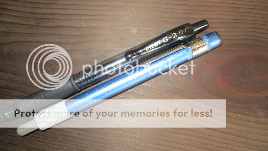

Skyhorse,
Where can you get that pen style one or what model is it?
Thanks,
Todd
If I'm not mistaken, that's a 'Buck Diamond Pocket Sharpener' (model# 97070; by Buck Knives). You'll see many available sellers online, if you Google it as such.

Skyhorse,
Thanks,
Todd
Todd I got mine from the Buck website,it's not very expensive and works great for it's size.You can even use the tapered end for serrated blades.
