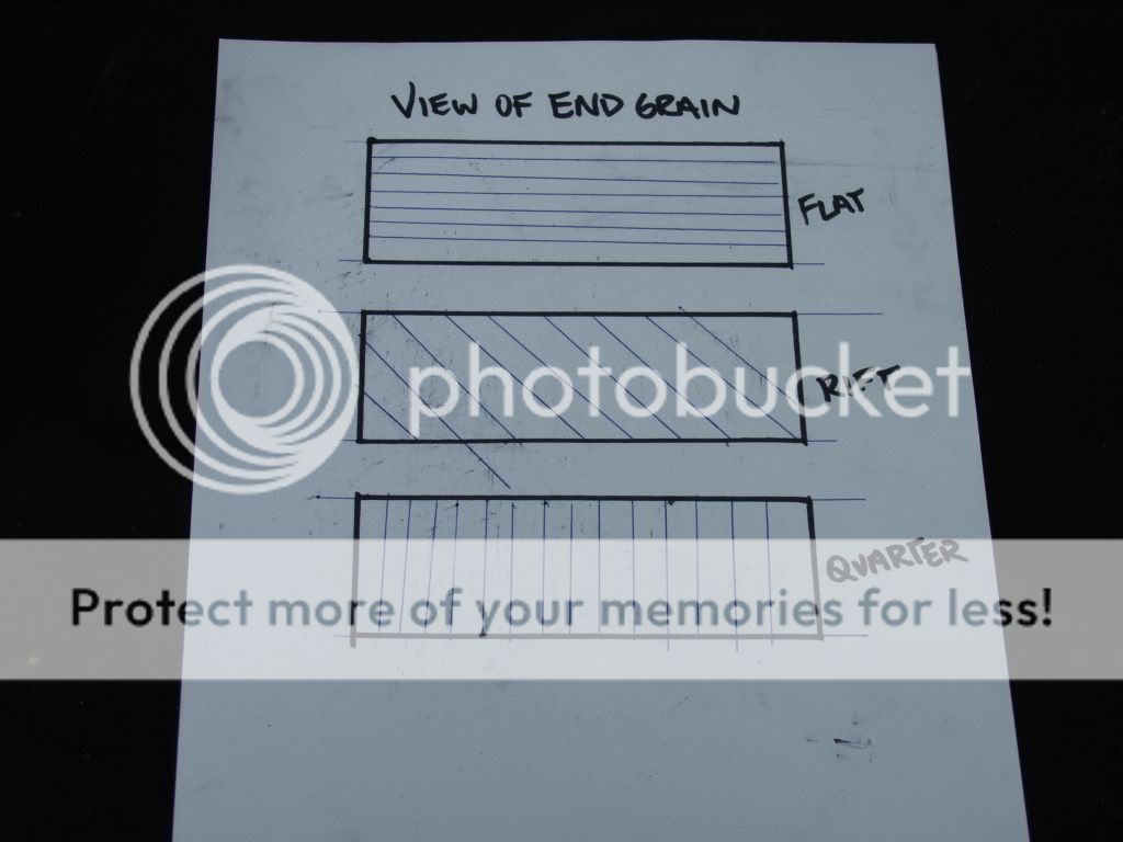

Here is an over simplified explanation of 1/4sawn, rift sawn and flat sawn.
Please excuse the dirty drawing.

The reason the face is called "quatersawn" is because it is what shows when the log is cut into quarters. It is more expensive because it has a very specific look and only eight quatersawn boards come out of each log (assuming the log is small and you want good recovery). In many species, perfectly quartersawn faces will show dramatic medullary ray patterns that will not show up on rift or flat sawn pieces. Quartersawn timbers also have superior strength and movement characteristics.
In short:
Quartersawn - radial (to growth rings)
Flat sawn - tangential
Rift sawn - in between
Through cut - what they call plainsawn (also known as boule-cut). Only one or two boards will be completely quartersawn using this method.

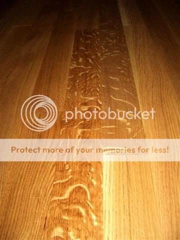

I hope you didn't think my comments were aimed toward you. If I had someone cut a log the way they showed in the rift sawn diagram I would fire them and deduct the value of the log from their paycheck. Especially with oak. When oak is correctly quartersawn it will cause really cool looking flecks caused by the angle of the cut to the rays in the wood.
Here is a photo of oak flooring. It is 1/4 sawn in a couple center pieces and rift sawn in the others. Big difference in the look and value of the different pieces.
Everything's cool brother. Thanks for the education.:thumbup: I really dig the look of quartersawn pieces.
I have a bit of sycamore I will cut soon to show the difference. Flat sawn it's just plain ugly stuff. Quartersawn looks like snakeskin.
