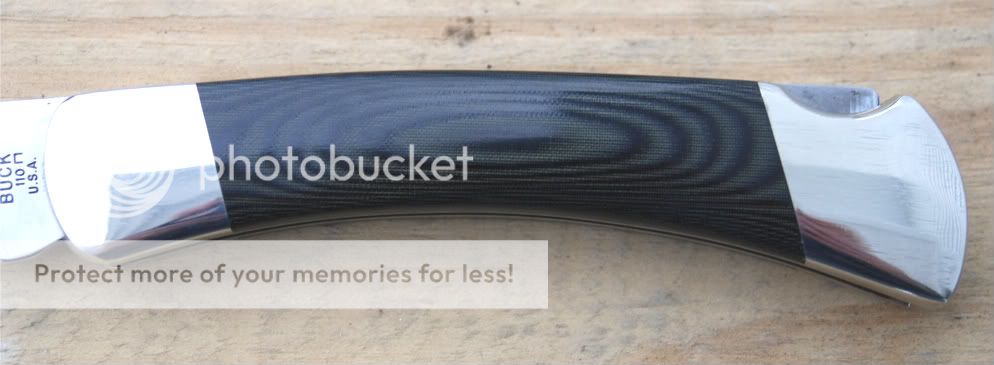

I bought this knife off the Bay from a fella for $47 total. It had what the box called walnut inlay but it just looked kind of gray to me. So I put ziricote and SS pins on it and that didn't turn out. The pin grinding got to hot (works good with brass) and scorched the ziricote. So I took that off and put on some black linen micarta with a bit of a palm swell. Thought it was interesting enough looking to share.
The pictures where a little dark so I lightened them some. The middle is about what it looks like to the eye.
Nice work FL. Putting that palm swell on the scales really brought out the layers in the Micarta.....:thumbup:
Hey thanks guys. I'm really pleased with this one. I guess I'll have to say I prefer the linen over canvas...at least at the moment. This is a little better picture on the scale. I see that the picture shows some scratches (and a fingerprint) in the bolsters. Maybe I'll work those out later today. Anyway, I purchased some rouge called Zams from Texas Knife Makers Supply and it does a good job polishing.

Great Job on the scale match up it can be pretty tough to get zero gap when you are profiling the scales by hand. I like the choice of material aswell canvas dosent show near the character that linen does.

Palm swell is when the middle of the scale is fatter and tapers to meet the bolster. In this scale when Gordon sanded it and left it fatter in the middle of the scale it brought out the pattern on the linen micarta.

When you put a radius on micarta, you have to be careful to make sure it is the same on both sides because the layers will look lopsided if you dont. You nailed it!
