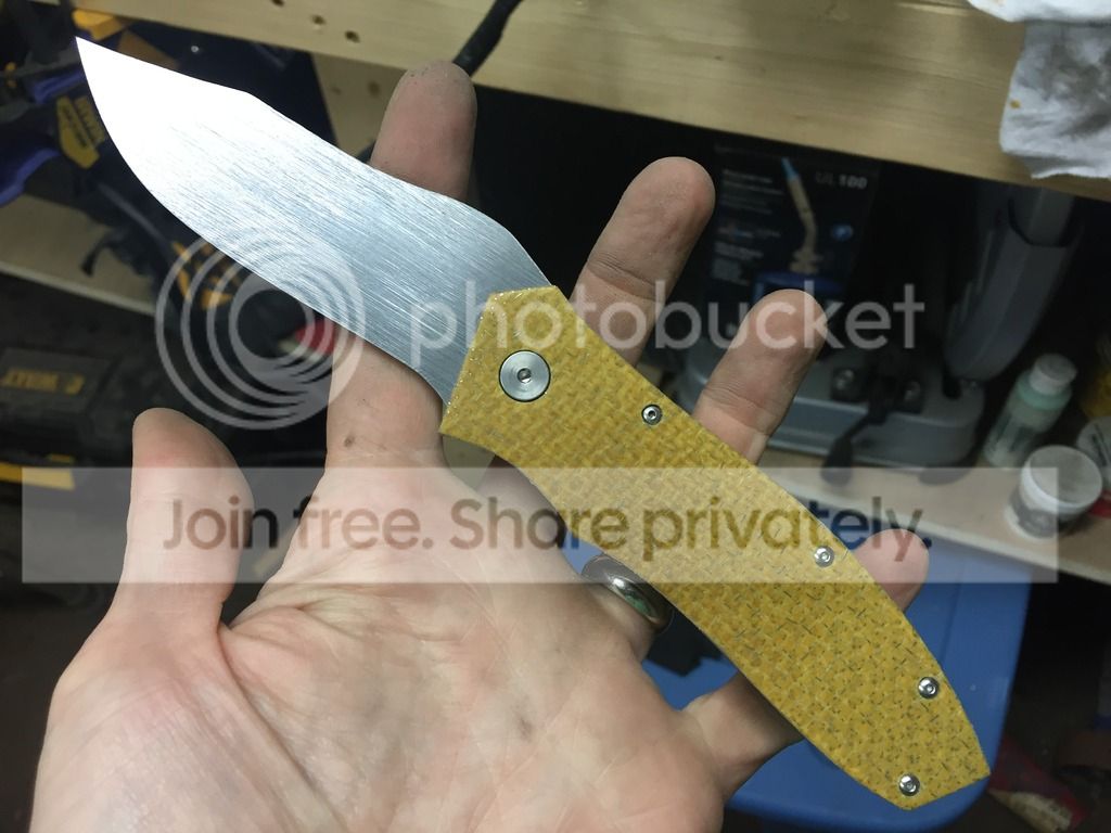

Here are a couple of pictures of the progress so far. It is far from finished, obviously, but it is turning out nice. The blade is CPM 10V with 0.062" titanium liners. It was supposed to have a CPM 20CV blade, but I screwed that one up. Luckily, I had just ordered some 10V that was just the right thickness.
