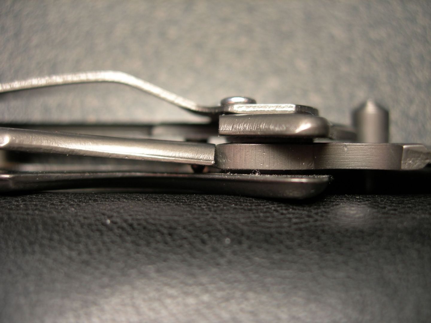

liner lock o.k. ?
The first little bit of dirt, and the liner won't engage and you'll be surprised. Send it back.
You want to find out just how insecure it is secure your fingers so they are not in the path of the blade and whack the spine a few taps on a pine board. I"ll be surprised if one of the taps doesn't close the blade on the knife in the top picture.
I'd suggest you can adjust this yourself by pushing it in with your thumb and then whacking it a few times and open and close it and compare the lock travel. It should seat and become more accustomed to traveling farther. This is one of my biggest gripes with both liner and frame locking folders. And people will argue with me about how great it is and yet no two makers ever seem to agree on what is the best way or correct way to make these style of locks.
You can leave it as is and just be careful with it. If the lock is titanium it will wear in and eventually travel farther. The stainless locks however have a much better wear rate and will not change much so if its stainless I'd suggest sending it in unless the little trick I told you works. If not I personally would not carry or trust that lock with any real stress on it. My fingers are more valued to me than that.

i "cycled" my lone wolf T1 many times. the liner lock now comes over about 1/2 way, however, it fails even a relatively moderate spine whack. so, i am returning it to lone wolf for service or replacement. thanks to all who took the time to share their knowledge. this is such a great place to learn !
