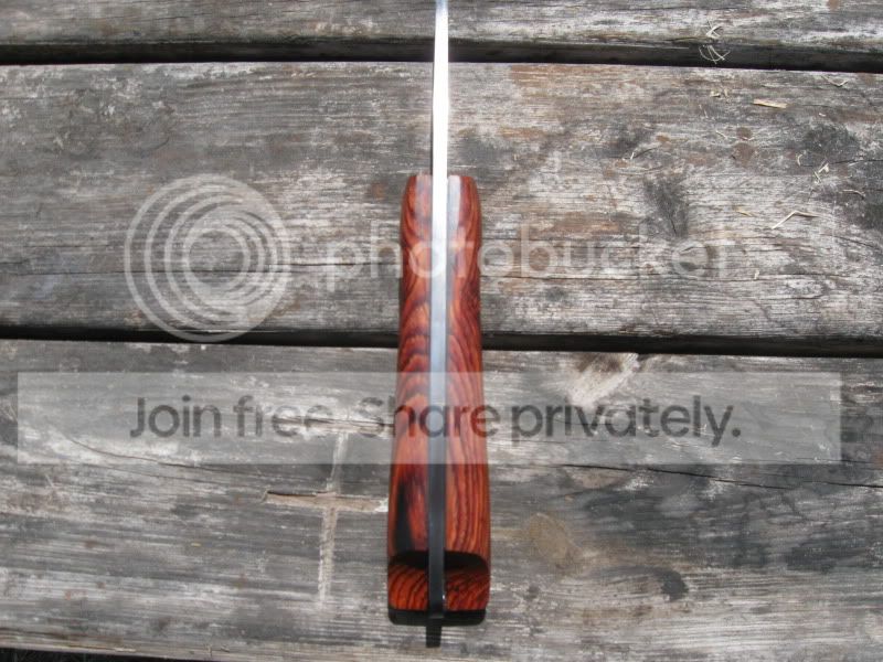

Ok so I am working on a knife and just glues the handles on. I let the glue set for about an hour and cleaned up the plunge and the liner mateial seems to have shrunk???? It is about a little less tha 1/32" , just enough to notice. I am thinking of cleaning out this area and adding glue with black dye. The handles are cocobolo with a black liner. Has this happend to you and how did you all fix this. Thanks again gentlemen. When I put everything together before gluing it was perfect.

I guess I may not have explained. the knife has a gap now on both sides where the handle meets the ricasso.
Without a photo this is just a guess, but could the wood have swollen, not the liner shrinking?

Here is a pic. I guess this might end up being my hunting knife now.
Yes, liner material does shrink. I found that out when I used it in some kitchen knives. If you seperatethe handle it is very visible it has shrunk. Frank
Well, I'll be darned; guess I've just been lucky. I take it the shrinkage happens pretty quick. As I said above, I leave a good bit around the profile while gluing up, I suppose the shrinkage is happening and I'm just not noticing it since there's still enough there to grind everything flush after it cures.
To clarify, I glue the liner material to the scales before drilling, with extra liner around the perimater of the scale. Then drill as normal after it cures overnight and shape/sand/polish the fronts of the scales. Then glue up the scales etc etc. Hope this helps.
