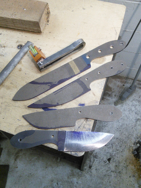

Peters trashed about 20 of my AEB-L blades with their torch straightening technique. I’m glad they did actually, convinced me to buy my own oven. They told me AKS sold me bad steel, just to tell you what kind of person Brad is, rather than admitting he screwed them up with the torch.
I used to send Brad blades in bundles of 100 or more. Almost every one I got back was covered with torch marks all over the back. I stopped sending them blades. I do my own again right now but will send them to Jerod Todd when I get going at full speed again.
While Peter's says the marks are only superficial, they are not. They show in the finished blade as a temper-line semicircle at the spine. Only way to minimize them was to use a 120 grit finish and then a coarse Scotch-Brite belt.

Put the area you want to straighten under compression (bend it opposite way) and use an oxy-acetylene torch with a small welding tip and heat the side you want to shrink (at the spine). A common propane torch will probably not get hot enough fast enough.

My experience was, everywhere that was discolored by the torch, a fine line would start appearing during hand sanding. The line would get bigger as I sanded, and everything single one of them broke. Every. Single. One. JT saw the picture I posted a while back and called it immediately, you got it heat treated by Peter’s, they straightened it with a torch, and they’re all going to crack where he hit it with the torch. According to Brad, from Peter’s, it was bad steel from AKS. Funny enough, I’ve never had that problem from anywhere else.
I had that problem with several blades, nitro v and some cts xhp blades. The worst part would be that the crack wouldn't really show until the knife was completely finished. A couple custom orders broke as I was doing the final sharpening.
I started flex testing the blades once they were rough ground and had a few more break. Now I always flex test at this stage and I always plan for a few fubared blades in my batches. Even with all these issues I still feel lucky that there are people out there willing to heat treat my blades. There are too many variables in all this to expect 100% success. It sure sucks though when you get a whole messed up batch. Its happened to me twice now and one time it basically ruined a years worth of my work, lol, live and learn. Id love to spend a few grand on equipment and start heat treating myself but I have no dang place to put the equipment.
