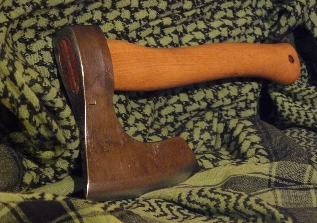

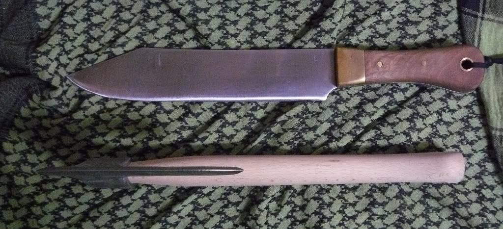

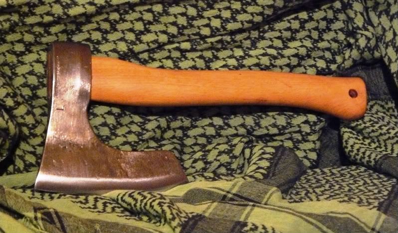

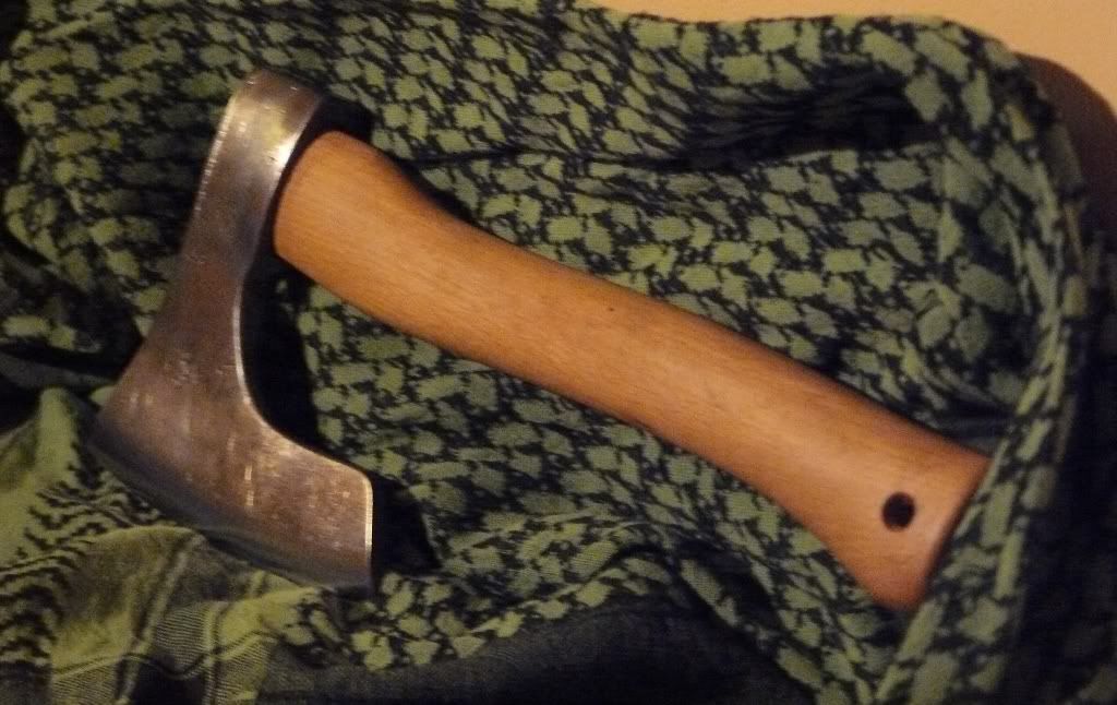

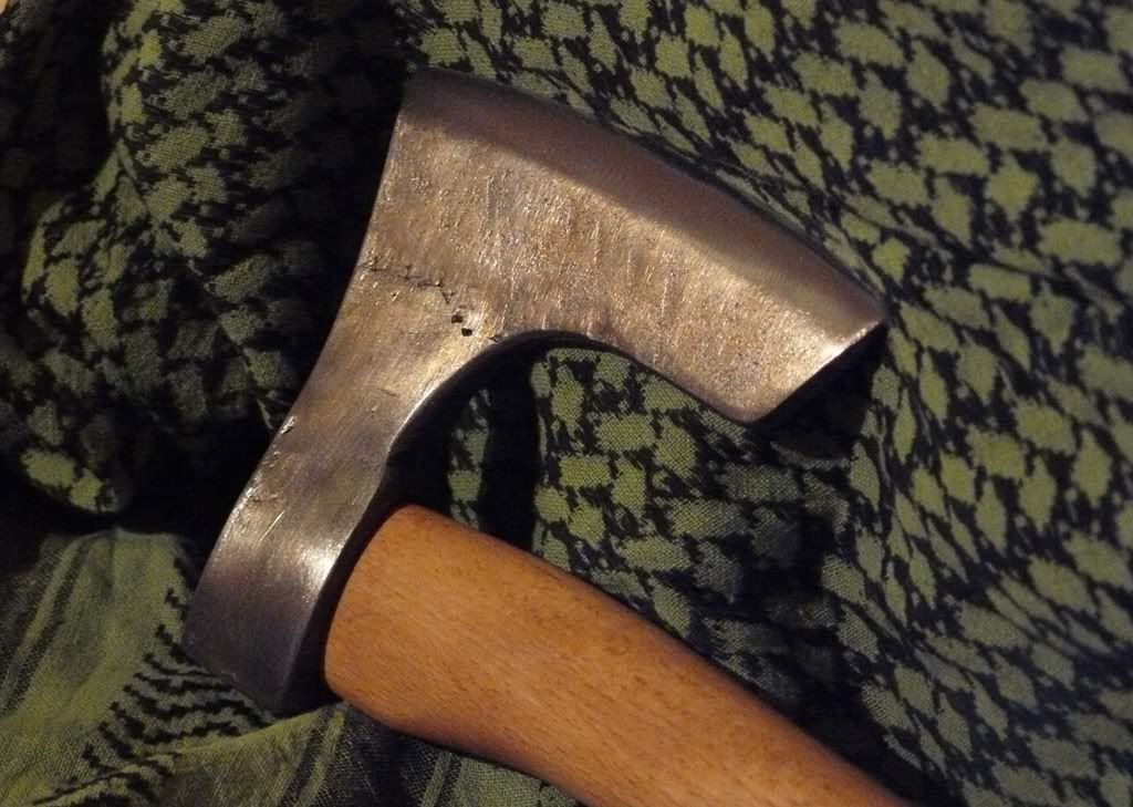

This thing was supposed to be my Christmas gift, but the time was not on my side.
It`s not finish yet, but, after so many GB (:rolleyes:), let see a romanian style little hatchet.
It`s called ~barda~, and it`s used by the carpenters.
My version is for bushcraft, a good counterpart to GB Wildlife Hatchet, light, small, versatile and useful for any kind of activity in nature.
I hope you like it! ;)
I will post more pictures when I`ll finish it.
Almost forgot, Happy New Year to you all!!!!!

What kind of steel and temper did you use?
I'm assuming it's either a spring temper or a differential to keep the beard from breaking off?
Looks like it has enough curve in the blade to be a decent skinner too. Nice!
DancesWithKnives
Thank you again!:)

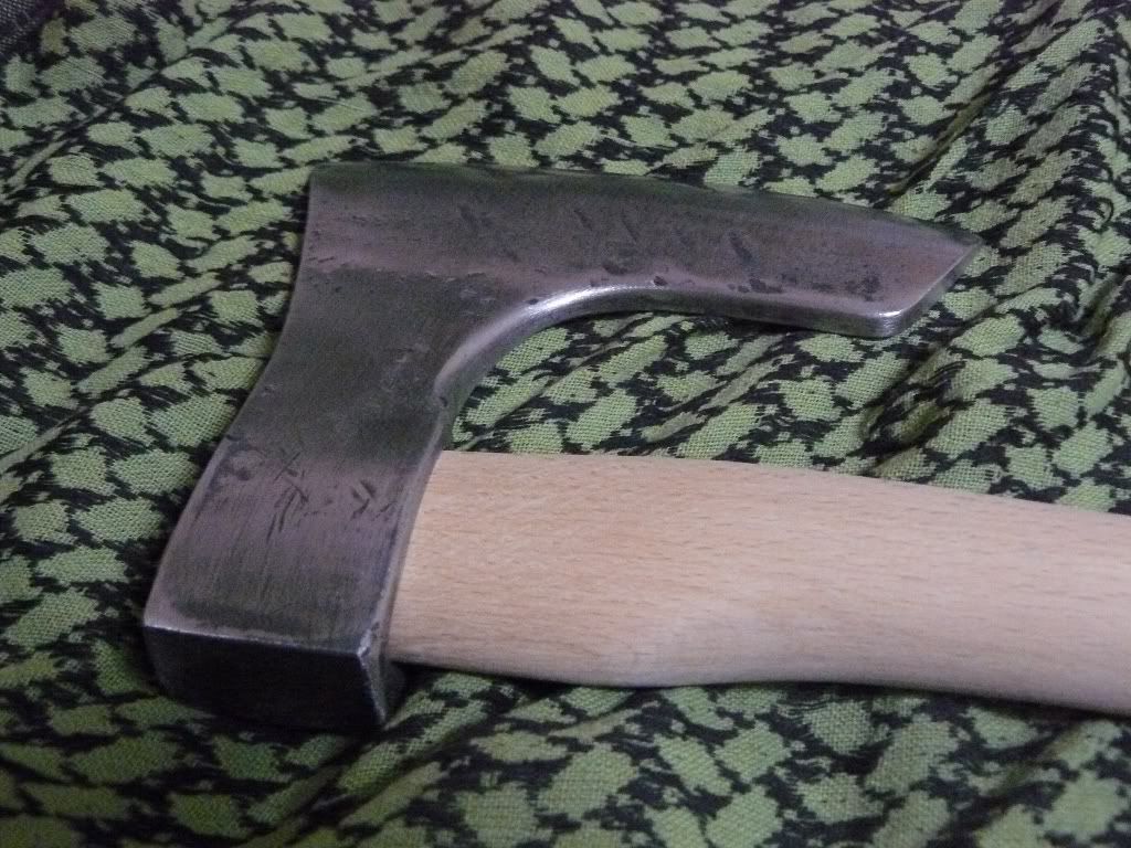

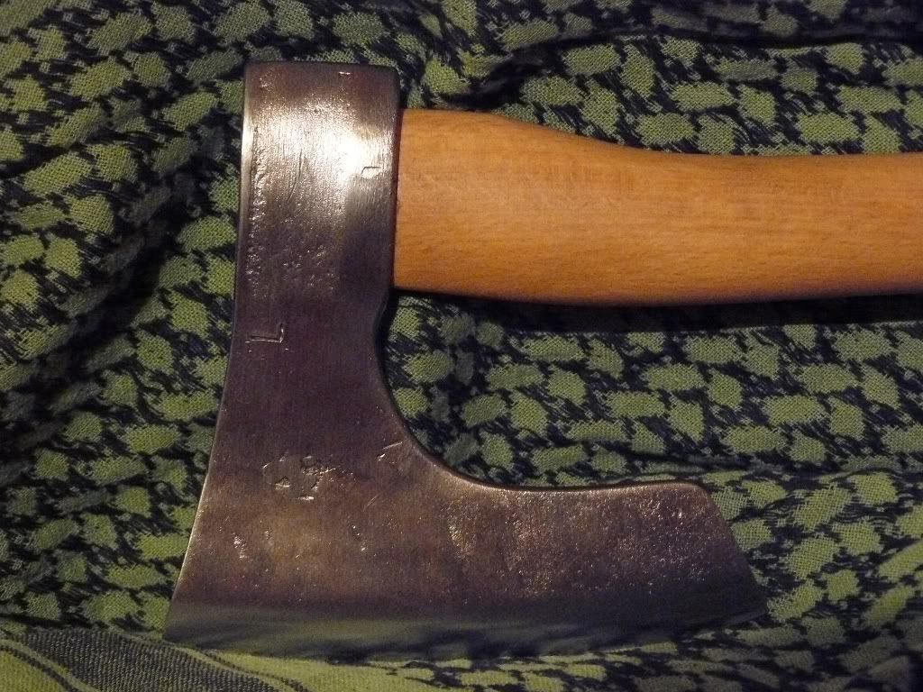

The little axe is made from two diferent pieces electrical welded (the haft hole from an old axe and a piece of spring steel).
The treatment is not ready, I will make a differentiated one - the cutting edge (around 1/2 - 2/3 of an inch) will be hardened like spring steel (heated to 1598 * Fahrenheit) and the rest will be softer (cooled from around 1200* Fahrenheit) to prevent cracks and to protect the welding.
After that I will normalize the axe at 482* Fahrenheit for half hour (250* Celsius).
The haft is made of beech wood (often used in Eastern Europe and Romania for tools) and it`s 12 inch long.
Of course, a leather sheath will complete the project!:)

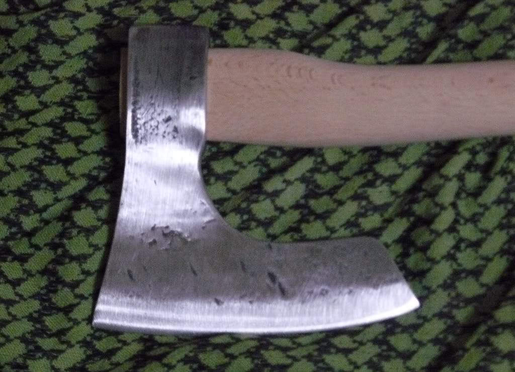

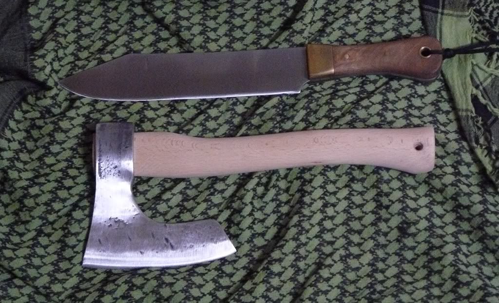

Now is better!
I made the heat treatement, sharpen it and I treated the haft with linseed oil.
Next is the sheath!
Enjoy!:rolleyes:;)
