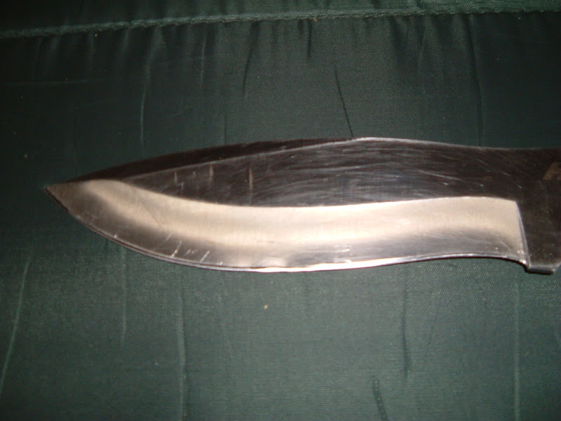

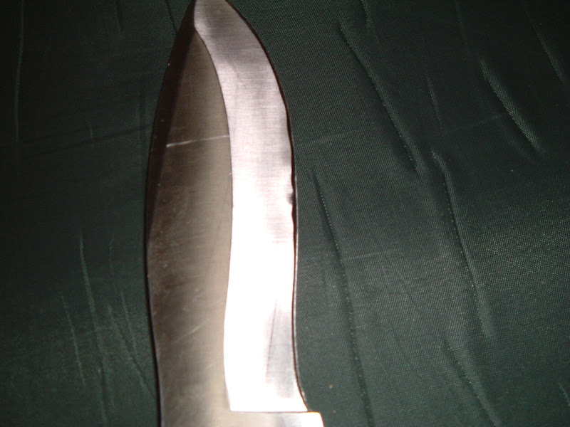

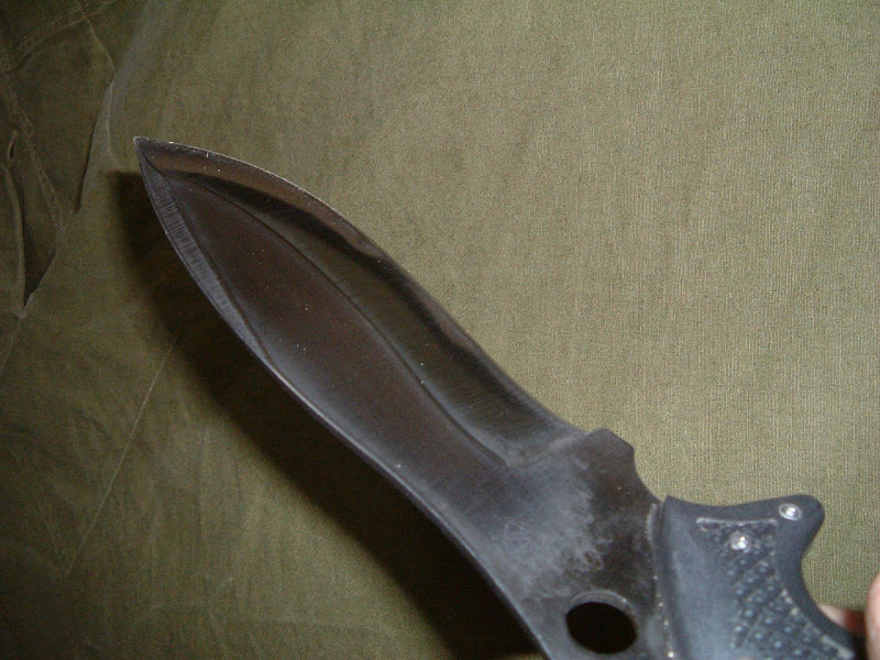

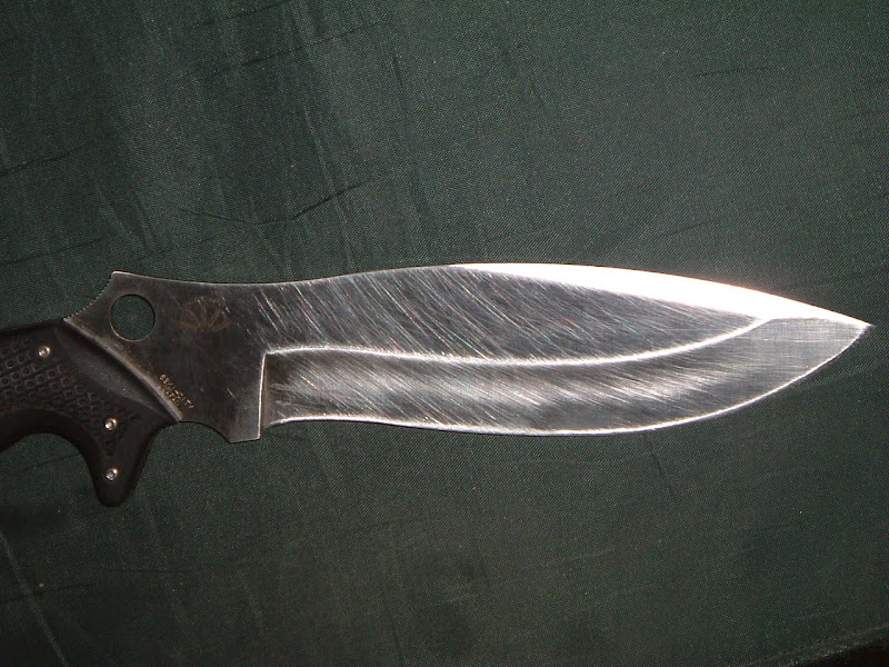

When I tried to cut off branches of tree, my Rocksalt was bent.
It happend at nearly out of the box and before swing-hardening
but I surprised it's durability(?) in comparison to forum statements.
Bent was little and maybe I used in a wrong way,
so tried to fix edge line straightness but it's difficult for me.
Still I like to use Rocksalt at cooking though its edge is bent,
but I've been afraid of using Rocksalt to woods and trees.
So as begginers I'd like to ask Rocksalt users about:
1. Anyone have ever happend like this?
2. Can it fix or is it worth to worry about?
3. What kind of attention do you have at cutting task?
4. Should I think about it's limitation of hard(?) use works?
5. Is it hard to happen after swing-hardening treatment?
sorry about poor English and photos, and lack of forum experience...
It looks like the edge rolled a little. If that's the extent of the problem then you should be able to straighten it easily with your favorite sharpening system. The RockSalt is a great knife but it's not an axe. I'm not saying your use was abusive but the edge of any knife will chip or roll if it hits something hard enough.
Judging by the scratches on the blade it looks like it's had a fair bit of use. I wouldn't worry too much. Just sharpen it out and use it.

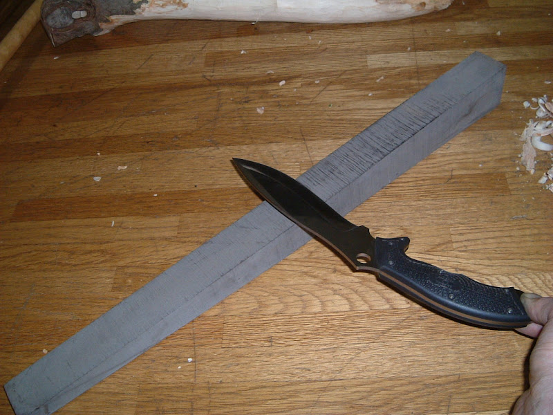

H-1鋼は分子間の隙間が結構あるらしく、叩く衝撃で硬度が増してゆきます。
最初に青竹を叩いている間も切り味が変化していきました。
そして鋼材が粘り強いため、鋼材の端材を電動金鋸で切断しようとした際に切り口が表面硬化を起こしてなかなか切れなかったため、
最終的にディスクグラインダーで加工することになりました。(G・SAKAIではレーザーで切断→グラインダーで成型)

さすがにロックソルトに脂つけたりするのは嫌だったので手持ちの端材で。
一枚目の鋼材右の方にある黒いシミは、こぼしたミシン油と拭き取ろうとした跡。
二枚目は側面全周を覆っている皮膜。
マイナスドライバーを入れても剥がれず。
圧延したステンレス系の鋼材ってこんな風になったっけ?
三枚目はディスクグラインダーで切り離した跡。
一番右のちょっとした平面は電動金鋸で切ろうとして挫折した跡。
グリススプレー吹きかけて拭き取る写真も撮ったほうがいい?

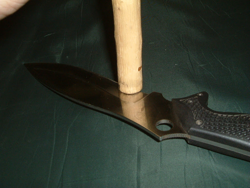

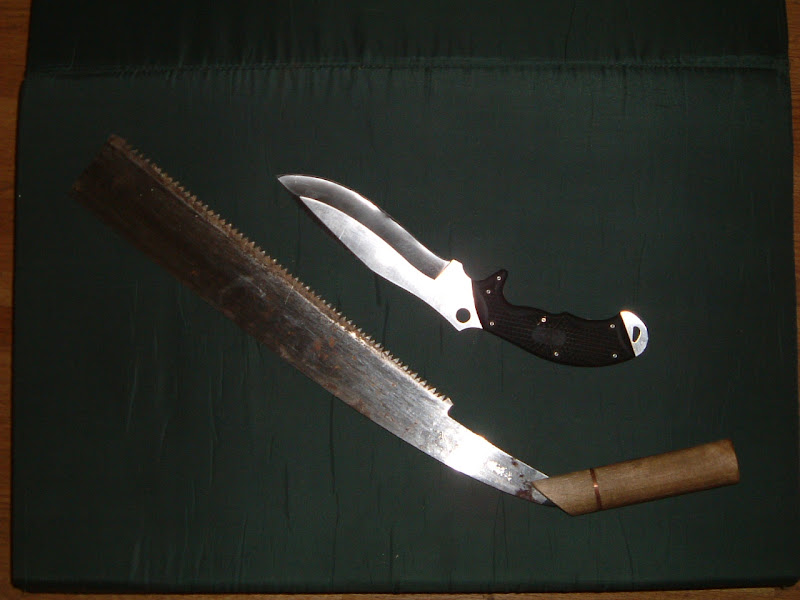

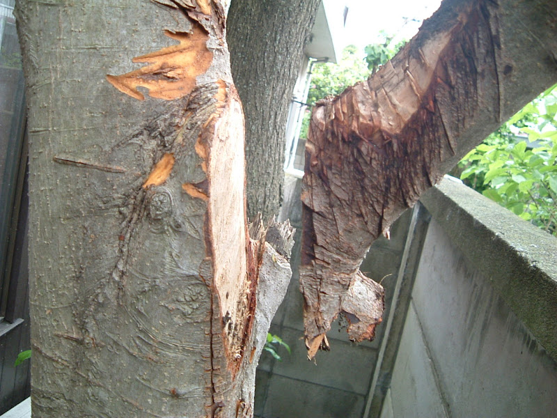

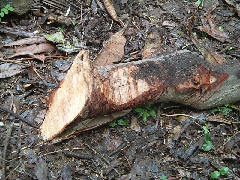

What type/species of tree where you chopping? I see the waves in the primary high hollow grind right at the belly. Did you get the blade stuck and twist the knife out? I'm trying to understand how that happened. I have a Rock Salt and have removed limbs from trees before (mostly pine, striped maple and cherry) without anything like what your pictures show. It looks like that knife has had a hard life so far.
I've girdled an 8" diameter Oak and sunk the blade in pretty far with no damage at all. Could you take a picture of what you were chopping?
G27
Dear ChapmanPreferred and Glock27

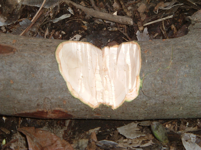

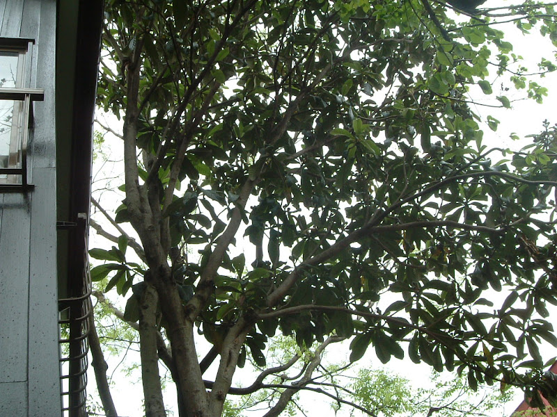

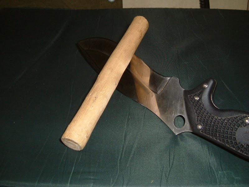

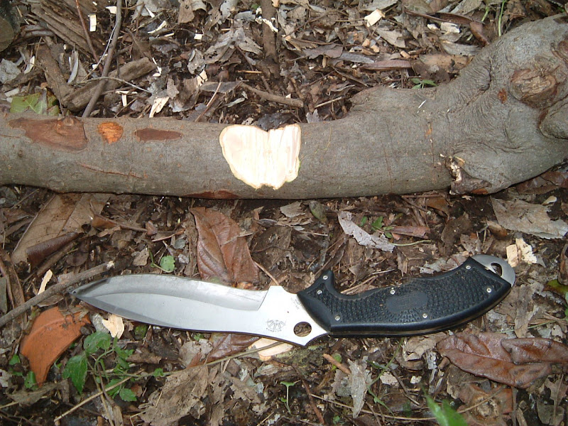

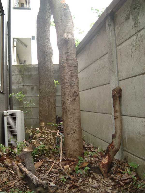

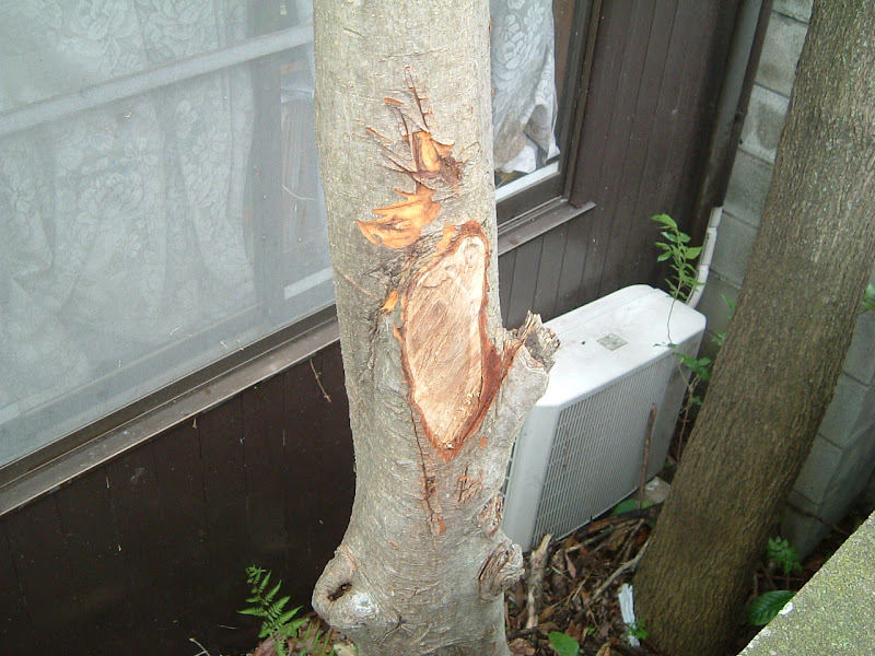

Thanx for reply and here's pics of woods and saw.
wood type is unknown
its surface is not so hard and its density is also a little low
seems to be including more waters than other woods in my garden
right side is cut-off branch
cutting surface with saw
branch that remains trial with Rocksalt
trunk and branch, difficult angle to right-hand swing
leaf and branch
Rocksalt and "Nakaya Heiji" saw
dried branch cutting test
cutting surface detail

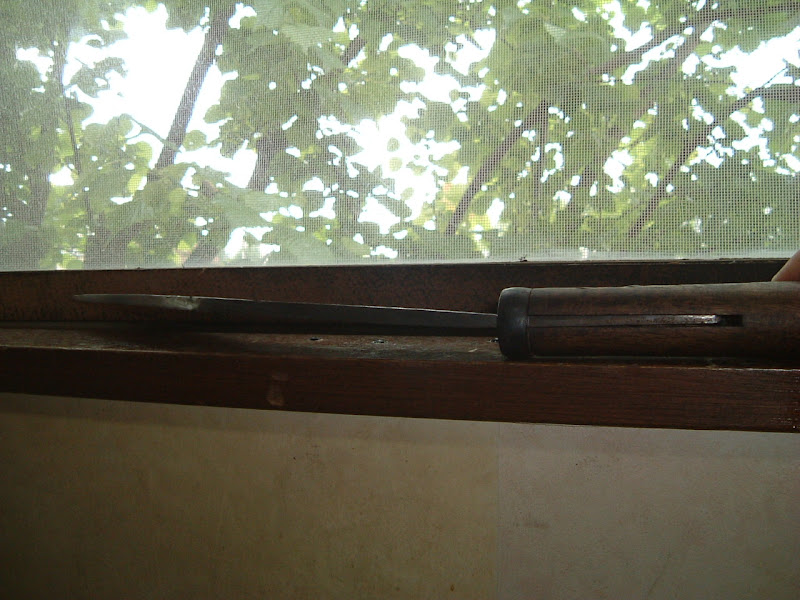

Excuse me I tracked past posts of ChapmanPreferred,
and found a thread "How To - Looking for a tuturial for convexing my knife.".
There was URL to tutorial and following to it,
I tried to change bebel line of Rocksalt to light-convex glind
by #100 sandpaper on Coleman's urethane mat.
Then I made 40 degrees microedge line and
slightly covered 50 degree stopping edge with sharpmaker.
Below pics are half-time result under constructing.
I didn't switch grind so seriously yet
But now I feel that I can adjust my blade on demand
and time will fix and refine my rolled edge.
I cannot judge that this is the best way to solve,
and I want to know other approaches to these problems.
Thanx everyone who suggested to me.
Yeah, that happens with H-1. I have to say it's a limitation of the steel. This is not the first time someone has posted about the Rock Salt bending like that. I don't see any way to stop it from happening.
If Spyderco were ever to do another H-1 fixed blade for chopping wood, I would have to recommend they give it a thicker edge, H-1 just bends too easily.
The upside is that H-1 is incredibly resistant to fracturing. On a fighting knife like the Warrior H-1 is pretty much perfect.
The Rock Salt still makes a beautiful utility knife.
Ikuyadas, my recommendation is that if you have access to a workshop with an anvil, you could try to hammer out the waves. Clamping the bent part of the edge in a vice and tapping the side of the blade might also work.
If you don't feel comfortable doing that, grinding the waves out would be better (as you've already started to do).

This makes me a bit nervous about using my Rock Salt (Or an Aqua) for batoning firewood like I was planning on trying one of these weekends...
This blade looks almost exactly like the prototype of the Rock Salt after it delimbed a dried up Christmas tree. The prototype was made of 15N-20 clad 52100 San Mai with a 5/32 thick blade with a flat saber grind. I've seen this "stretching" of the steel on some of the large competition cutters in Bladesports.
This can happen when you discover a knot in a timed 2x4 cut. If this buried limb grows close to but not on the line of the cut. The softwood around the cut will cut easily until the edge encounters the almost parallel knot or dead branch in the lumber. The edge will follow the knot and the blade will follow the cut through the mass of the 2x4. This leads the edge to stretch around the knot.
The bad news is that it is near impossible without heat treatment to restore the edge, and that is definately not an option with H-1. The good news is that this will probably not lead to major failure. I've seen this material bend 90 degrees without breaking.
In part this is bad luck. It will probably not effect the usefulness of this blade. And the more it is sharpened and used the harder the steel will become...Take Care...Ed

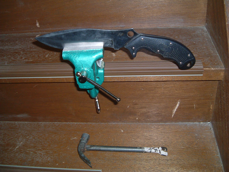

1. Thanx to Joshua J.
I clamped rolled part of edge in a small anvil
and tapped both side of the blade with a mini-hammer
and kept clamped position about 24 hours.
Wavings were decreased so as not to mention to me
when I slide it on my nail in comparison
but it didn't be removed completely
if I touch both side surface of blade.

Dear Ed, thanx to correct my mistake and tell me a way in reason.
How about these to burnish? Is it appropriate?
