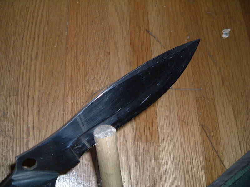

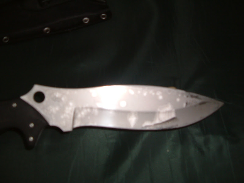

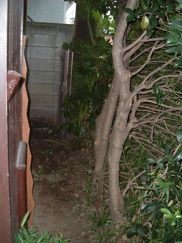

When to maintainance back side of holly wood shrubbery

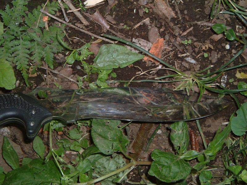

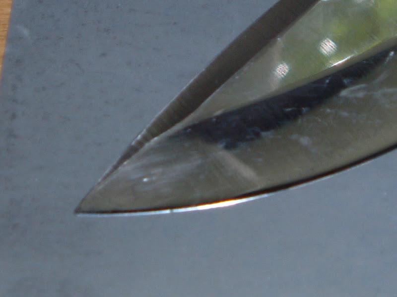

blade met knot and roll recurred again

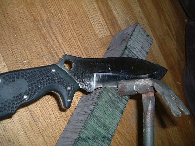

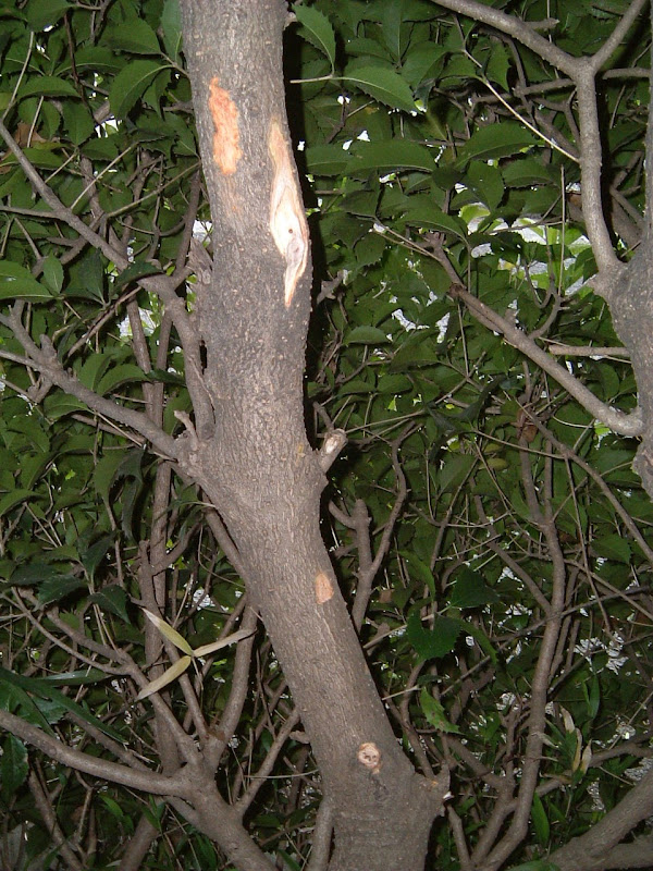

first I made wounded edge scratching to the trunk of the tree

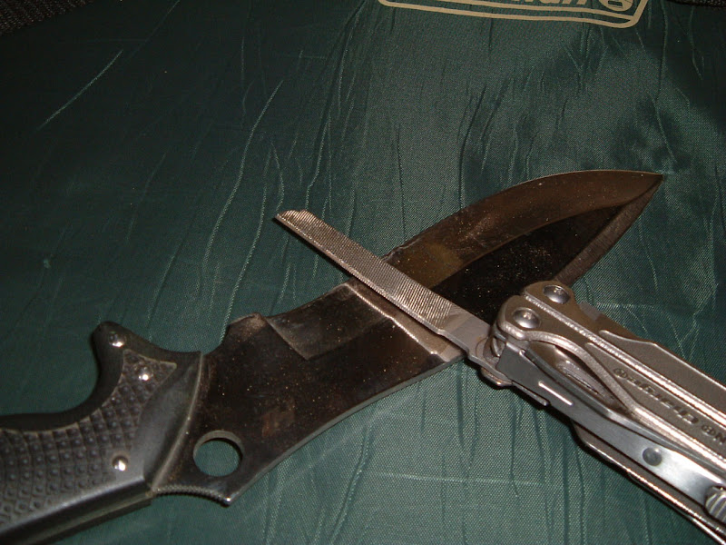

second I filed edge with Leatherman Charge TTi (unnecessary?)

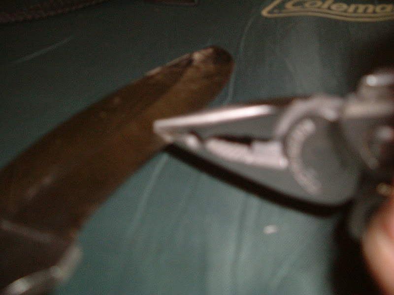

third I clamped the rolled part of the edge with pryor
and tried to bent (usually slipped and edge scratched)
but after that roll remains still
fourth tried to made jig to correct edge
but it didn't work because its groove was thick

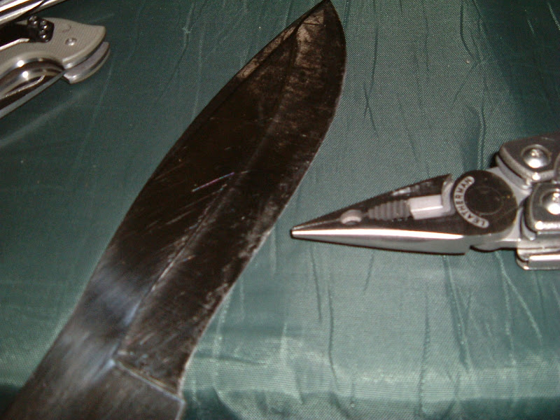

finally I hammered both sides of the blade
blade didn't bend and edge didn't chip

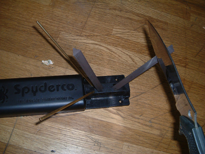

and took Sharpmaker (mediam stone), and #2000 sandpaper
waves didn't disappear but temporary repair was possible
http://lh3.ggpht.com/_KfISOT21EPw/S-0pdPhFt3I/AAAAAAAALT0/Dy1Np8BJpGY/s800/DSCF0193.JPG

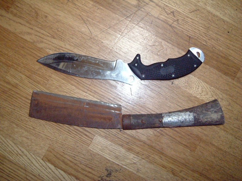

I limbed off same tree two days ago,
then no rolls/waves and any problems were happened
except my mistakes injured front part of the edge.
On the other side I used to chop with Japanese traditional "Nata"
and probably I used Rocksalt at the same way.
I have handled Nata very roughly and
did not consider to thickness, grind, and weight of Rocksalt
when I rolled its edge.
