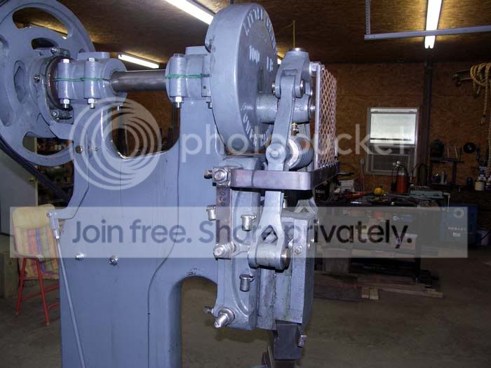

Chip & Don, I see the front pics of the guards you made. did you use existing bolts or tap new holes for the cage? Any chance of a pic showing how it is attached?

Dean, I bolted mine to the top ram guide bolts. On the left side I brought a piece down that bolts to the middle guide bolt, to keep the thing from pivoting. I'll try and get a side shot latter.

Dean, here's a side shot.
I used 4 pieces of angle iron, welded to the guard. Then I bent and twisted them to fit to the top and bottom blots on each side of the ram. On mine, I bent them so they would not interfere with lubing all the places on the ram. Will try to get more detailed shots for you. Mostly it was ham fisted together. Used 1" angle and some expanded metal from the scrap yard. Since my welding leaves a lot to be desired, I probably spent as much for welding rods as I did for the rest of it.
