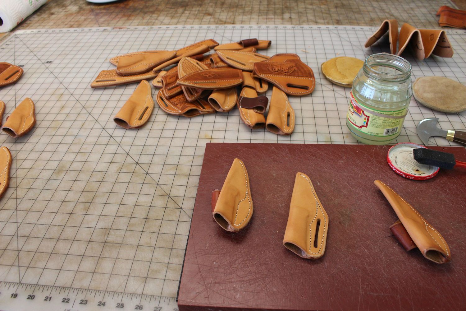

This was something I came across by accident. I've done it twice now and the difference is significant enough this will be my standard way of proceeding from now on. What I'm talking aobut is edge finishing or rubbing of your edges. Traditionally a product called gum traganath has been used in leathercraft to help smooth out the edges. You applied this wet to the edges and then rubbed. The gum helps flatten down and slick the edges. Sometime back I tried a new product called Wyoming Quick Slik from Sheridan Leather Supply. I liked this so much better I tossed my remaining gum away and have used this stuff exclusively ever since. I'm on my 4th quart so can recommend it pretty strongly. But, that is not what this is about. Its about how to use it.
When doing sheaths I would put it on the edges 3 sheaths at a time. Thats what is going on here:
The Quick Slik is in the old pepper jar. I apply it with a foam brush and then keep the brush with the jar using that rubber band around the jar. Get lots of uses out of that one brush. So I'd brushed up 3 and was just getting to ready to rub the first one and the phone rings. I end up talking with the customer for quite a while and all my Quick Slik had dried when I'm done. So I paint it on again and rub it and wow! I was already getting very bery good edges but this technique bumped em up again. That was a few weeks back.
Well that happened again. Exactly the same way, phone call again. So I ended up doing a whole batch that way: putting on a coat letting it dry, recoating and then rubbing. Didn't even take that much time. I still put it on three at a time. By the time I got done with the 3rd the first was ready for its recoat and rubbing.

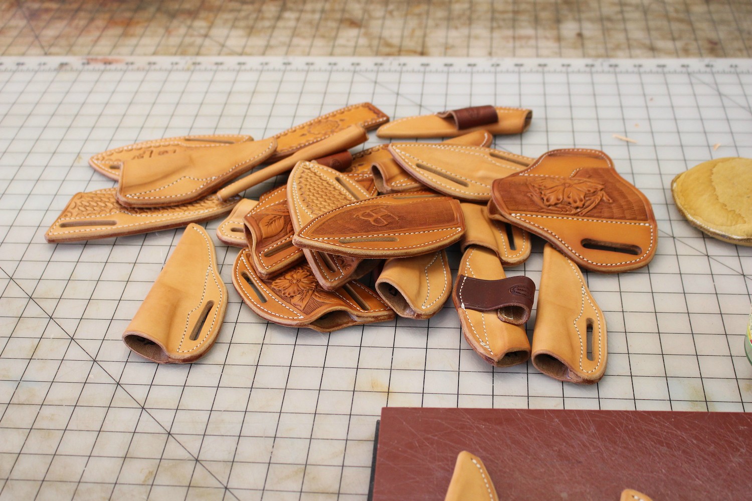

So I did all these:
Ang got em done.
What I found is that I get a more uniform burnish, more consistent color the whole length of the edge and a higher gloss. Just smoother. If I had to put it into numbers say you were happy and getting what you considered a 10 on your edges; doing it this way gives me a 12 or 13. Now I will still put two coats of Bag Kote on the edges as a finish. But I'm liking this might give er a try.

Great tip Dave! I gave up my Saddle soap (for the most part) after trying Wyo Quick Slick from Sheridan Leather. I've found the following to give me glassy smooth edges: Dye your edges if desired (and let them dry). Wet edges with water, burnish with my cocobolo drill press slicker to get things started using Quick Slick, burnish again using Quick Slick with heavy canvas, let it dry a little, hit it with 500-600 grit sand paper (this is where things start to get really smooth and glassy), then go back with your finger and rub a little saddle soap (white paste from the tin) on top. Once everything has dried and remains glassy smooth, I seal with another Sheridan Leather product called WyoSheen which is a lacquer based sealer. I have found no better way of doing it thus far and have tried a lot of edging methods and products. I'm going to have to try your dry time and multiple coat method, that is very interesting!

Gadsen that really is it. We got to keep trying different things I think, can't get stuck in ruts. Mt pretty much on the same page. I rub all the edges first while damp, just prior to wet molding, then wet mold, bake and then let em sit on the counter overnight. Next morning is when I do the Quick Slik. Those that don't know I use a turned rosewood stick in a wood lathe set on warp drive to rub the edges.
