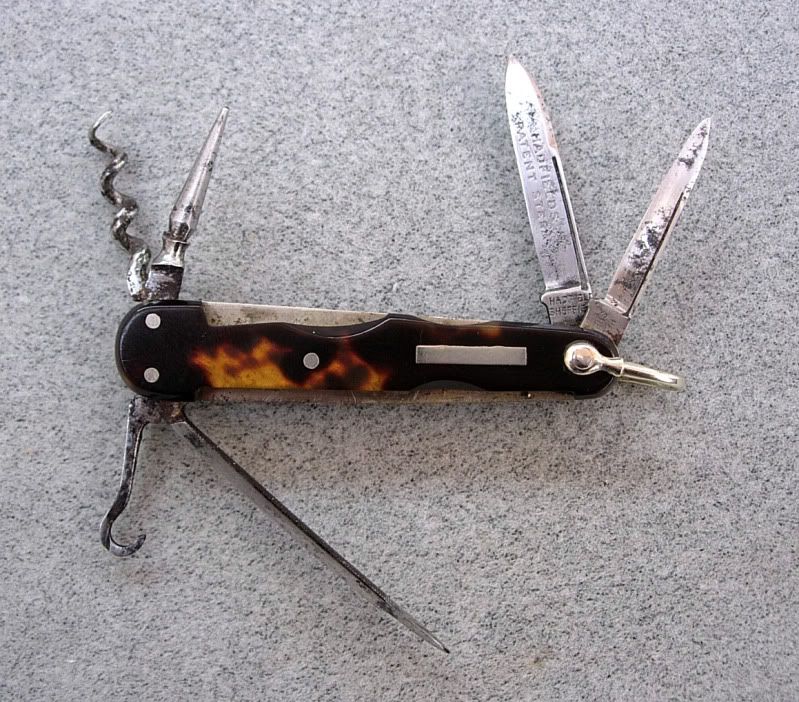

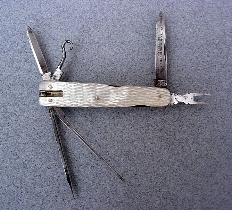

Thanks to zerogee for the link showing that fascinating lobster knife under construction. Here are some Sheffield examples for you. I hope you enjoy them.

Ahhh, smiling-knife and his wonderful Sheffield treasures!
That had to be the hight of the cutlery industry of Sheffield, the late 1800's to early 1900's. Looking at s-k's lobsters I think of wood paneled drawing rooms, strait stemed Dunhill pipes, good English blend tobacco, and a nice brandy after a day afield with a nice light side by side Holland and Holland. Can't help it, it's the romantic in me. Now I'll go make myself a nice pot of tea and smoke one of my Petersons.:D
