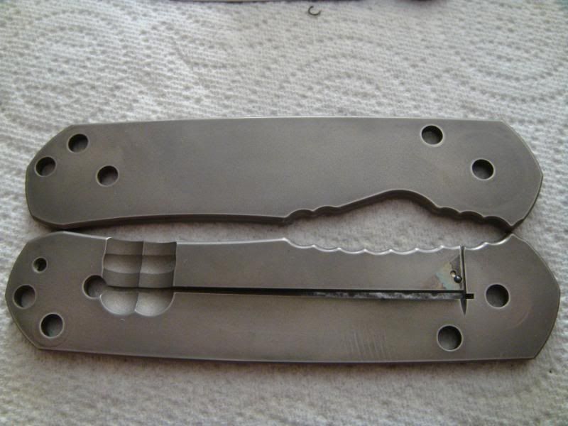

I am about to take it down and clean it up, rotate pins and screws.....see how that works.

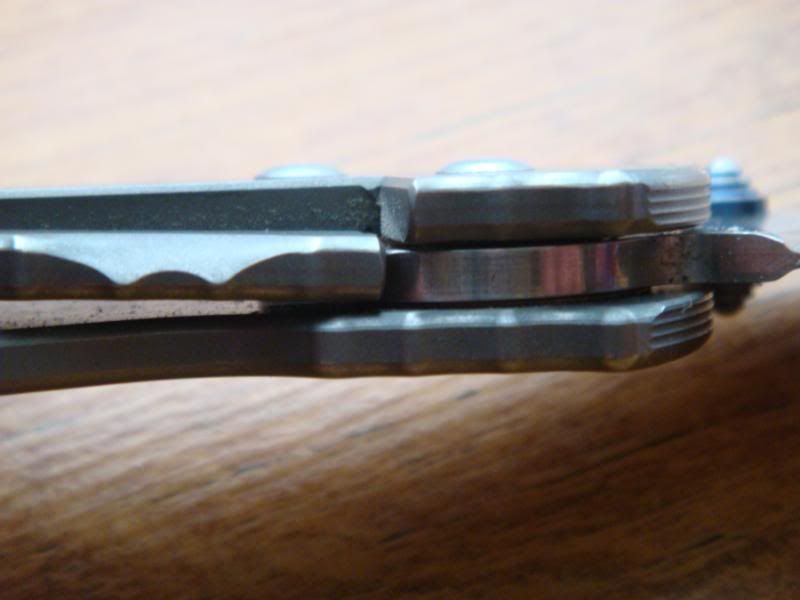

Original Lock Up

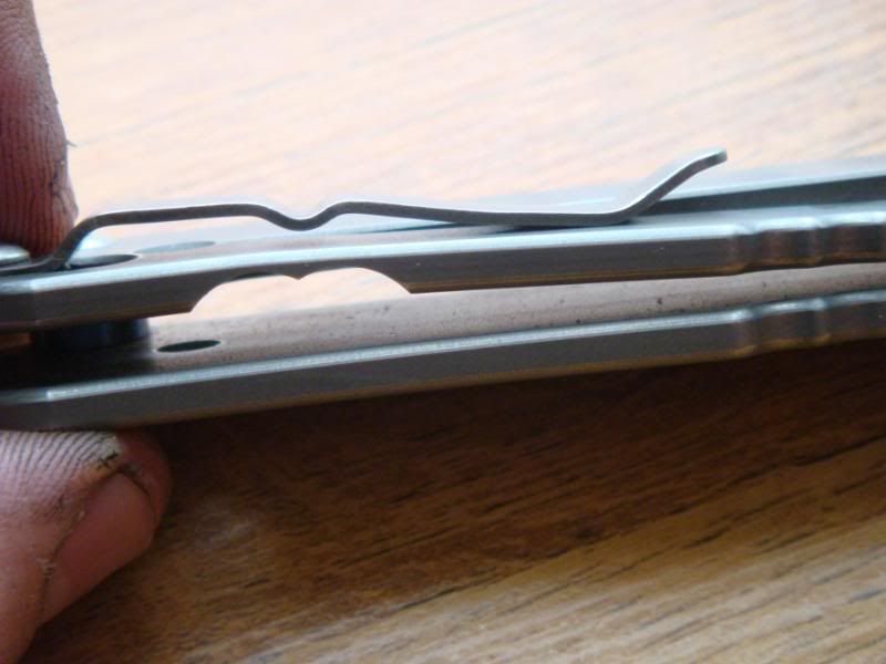

Clip pressing on Lock Bar while open........is this bad?

After cleaning

That looks like 90-95% so you're in good shape.

Yours has the new style clip.
You can bend that clip a little so it is just barely touching closed
and just barely not touching the lock bar open and locked.
The way you have it puts a little extra pressure on the lock bar.
