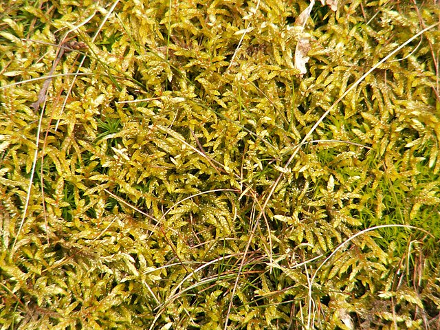

I wanted to learn more about the natural insulation used in these Finnish log cabins.
The moss used between logs is called "Seinäsammal" in Finnish, which is the species Pleurozium schreberi, found "on the floor of the boreal forests of Canada, Scandinavia and northern Russia" (according to Wikipedia).
Other materials used for stuffing the cracks (once the walls are up) includes hemp, flax, and jute.

"Moss was usually collected in the summer... It was dried over the summer..."
"Wooden houses are commonly insulated with sawdust... usually half sawdust and half wood shaving... If thoroughly dried when stuffed and kept dry, it generally remained in place for decades..."
"Older wooden building floors can be safely used with traditional peat or sawdust insulation, or new insulations linen-wool or wood fiber pulp..."
"Peat properties have been compared with other insulation materials... Acidity of the peat was able to prevent the worst building-destroying fungi growth, even though the roof had leaked from time to time...
"Dry rot is a common but dangerous basement damager... Bog moss and peat are so acidic, a pH of about 4, and are likely to even prevent rot fungus growth..."
