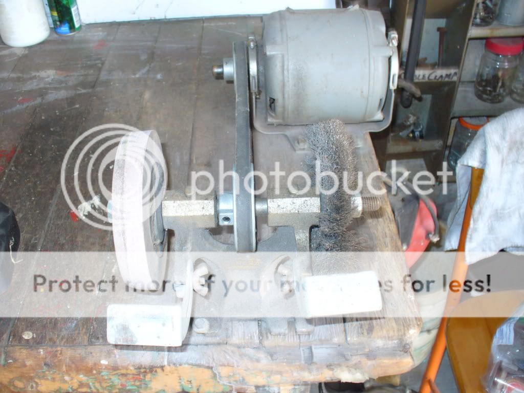

Anyways, about the benchgrinder. My pap just so happened to be a precision tool grinder :D. We have "something" on the workbench at the farm, although I have no idea what it is. All i know is it has a stone wheel on one side and a wire brush circle on the other side. Does that help lol?
that "something" should work fine for a maul. actually, the wire brush wheel could do a good job of reducing the burr and finishing the edge somewhat, but i've never tried it.
keep it cool and take a peek after each pass on the stone to make sure you aren't going too far.

This picture is the "something" I was talking about

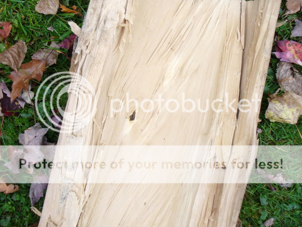

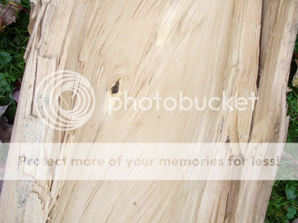

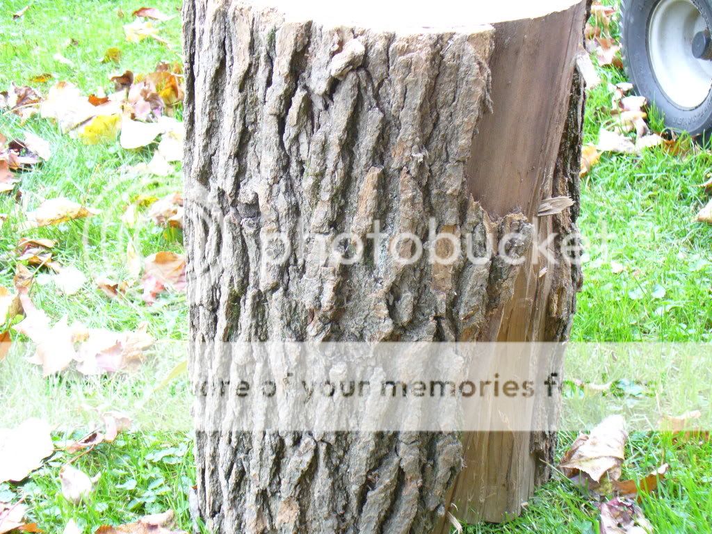

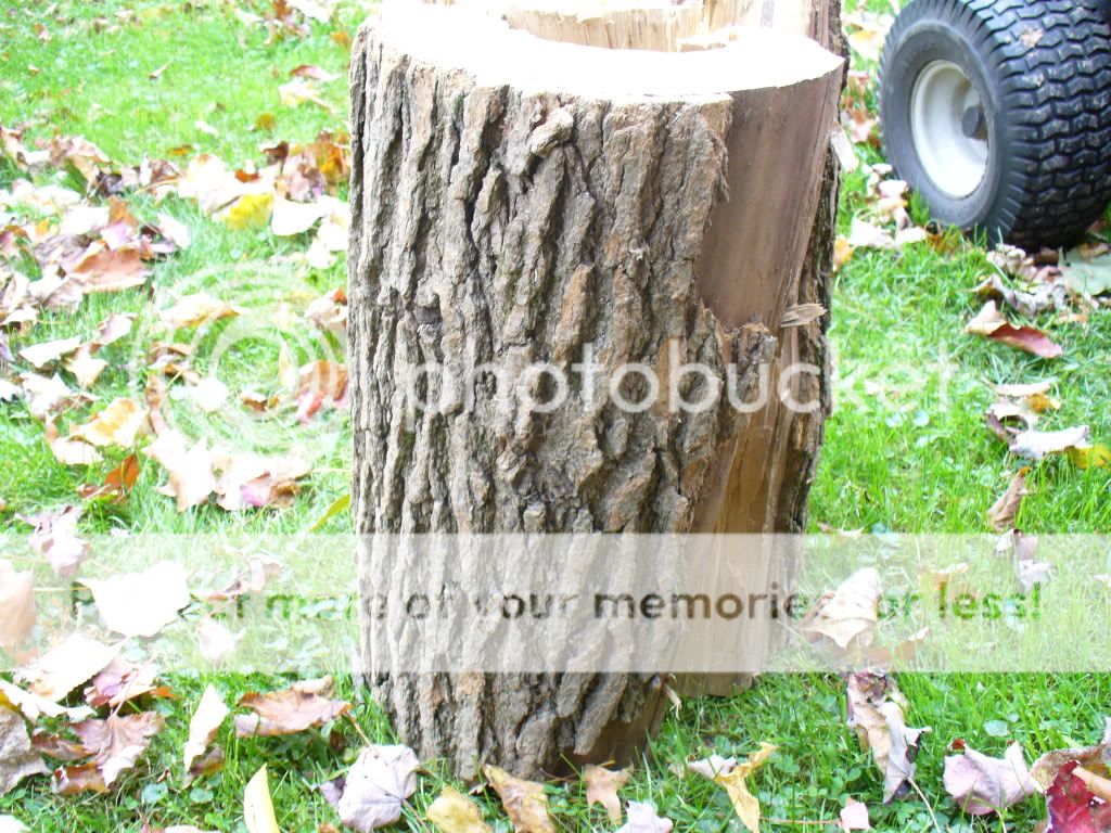

The next 4 pictures are of the mystery wood, that we finally almost split. Hopefully someone can help me out on what kind it is, and why it's so hard.

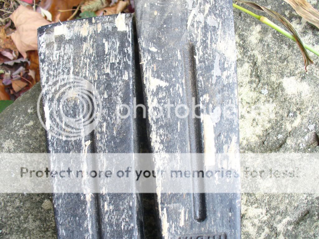

These are my new wedges, that did pretty good if you ask me. Notice the white mud looking substance on them. That is from the mystery wood, if that helps at all (also, it didn't seem wet when we were splitting it, but who knows)

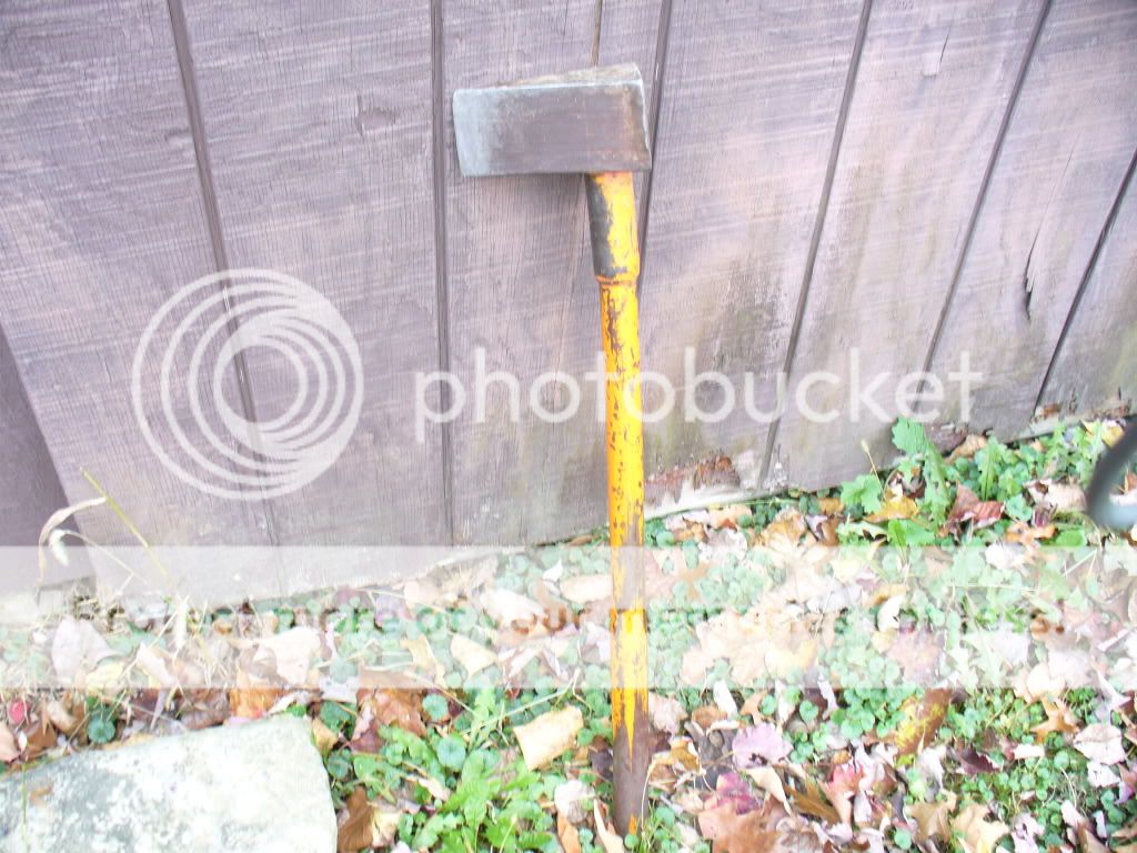

This is the maul that we used, along with the Fiskars Super Splitting Ax

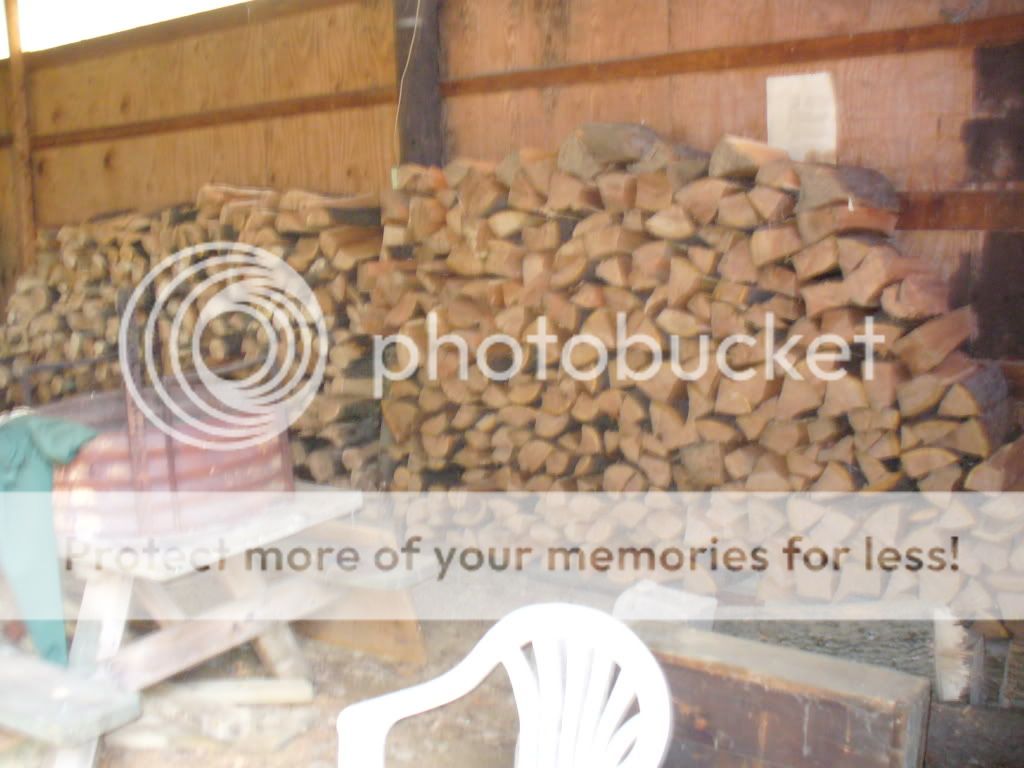

And finally, the end product. Despite not splitting a chord of mystery wood :D
I'm no expert but it looks like an Elm. Probably American Elm.
Do you remember what the leaves look like?
No leaves my friend :thumbdn:
It was down around 2 years before we touched it. All I know is that there were A LOT of branches coming off of it(it being the main trunk)
It looks like seasoned locust to me. If I leave locust on the ground here more than 6 months I can't cut or split it without alot of effort and dulling.
I thought that too, but doesn't Locust have thorns on the branches?
