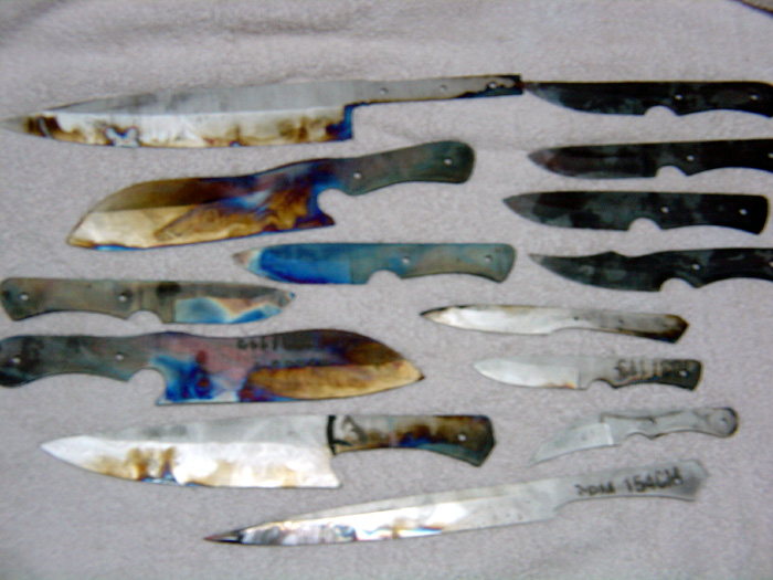

14 blades heat treated tonight and i told deker i would be done by 1200 and i am sorta i had one more i was thinking about doing but it would have taken till about 1 to do it
looks like i ll be doing a load of small stuff and wild steel later this week
well that was all 14 in the dewer over night and the temper starts tomarow
btw they were all cpm154 for those interested
butch

sometimes you just want to leave some of the knives the way they come out of heat treat
the colors are as quenched not tempering colors
the temper is 400 as per my evenheat kiln so no i didnt over heat any thats jsut some of the air from in the foil pack
I don't usually get a chance to see knives before thay are finished... That IS some cool coloring on your steel! :) BTW I like that scimitar_ish shaped blade on the right side, 4th down from top. :thumbup: :D
