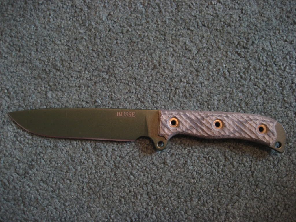

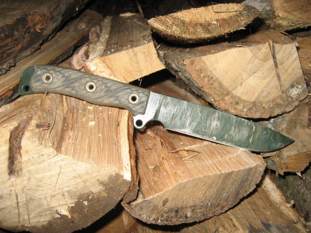

Sorry I don't have a BOSS Jack yet so these will have to do...just for illustrative purposes...
Pumpkin LE with blue liners.
Full spine shot
The Jack'o'lantern & PuMUKin LE hunting combo.
A Bruiser proto user (stripped) among birds of a feather.
A shot from when it and the Gladius were new.
And I can't leave out the one I proposed to my Sweetheart with.
