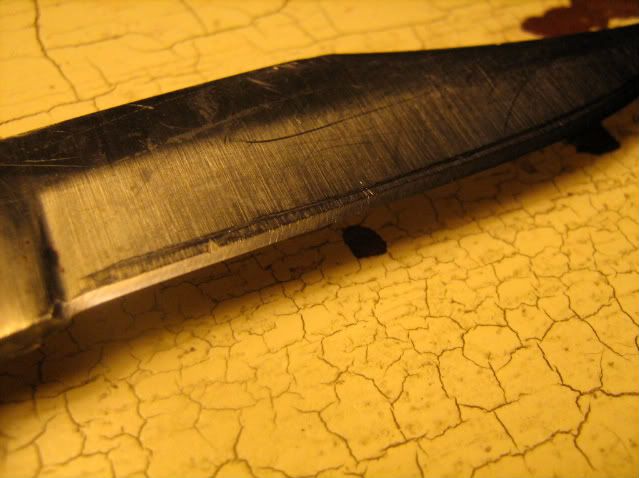

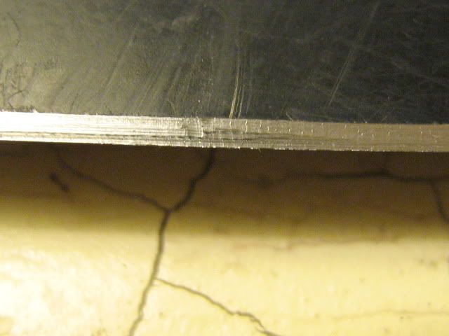

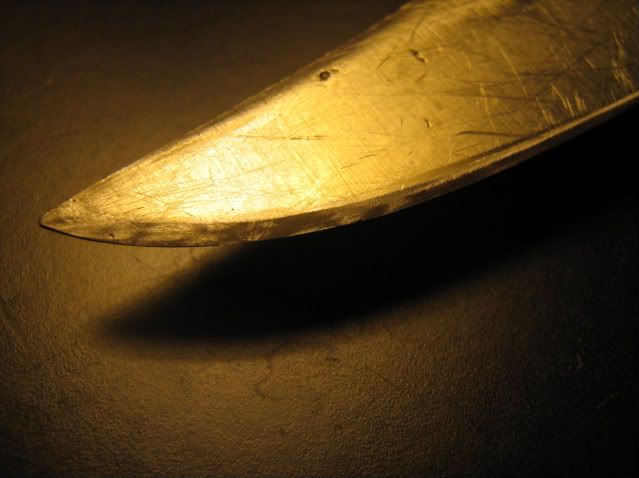

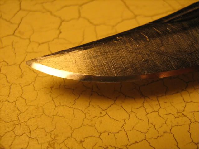

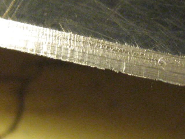

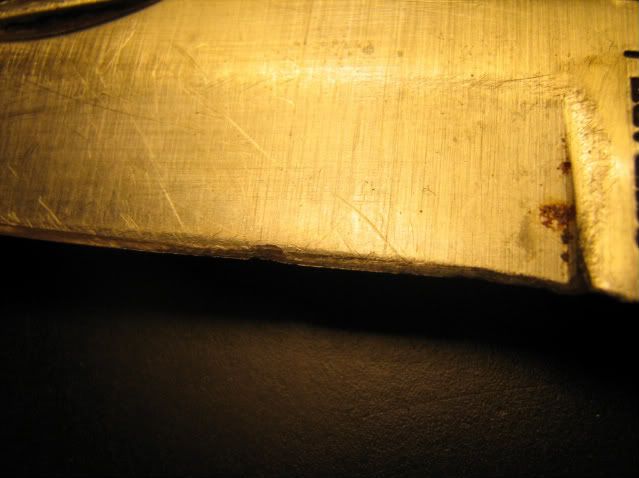

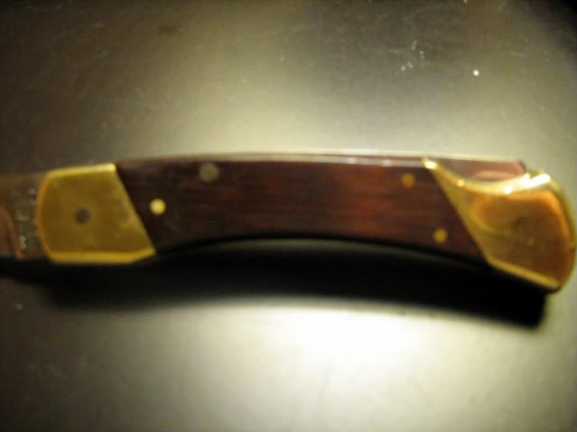

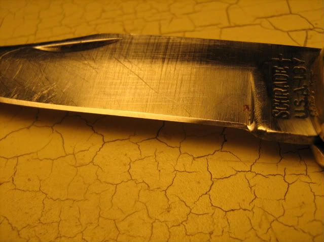

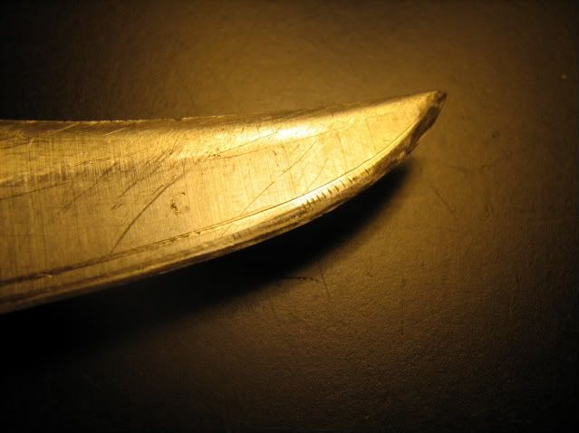

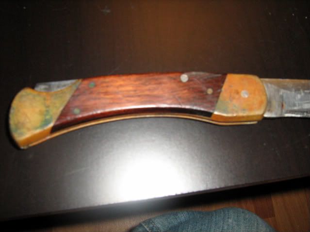

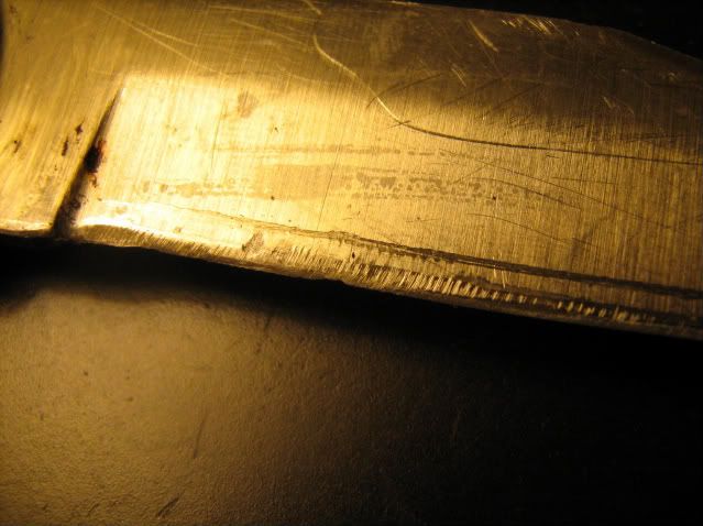

I got a few knives in last week from one of my dads friends that needed sharpening. The only sharpening tools this person has is a carbide scraper and I think he also tried using a file. One of the knives was a old schrades lockback that had seen a rough life, I didn't even want to touch it at first because of how damaged it was but I've seen worse and knew that I could fix it.
I was not even going to post this but with what seems like a recent wave of people saying that they use one of these type of sharpeners I figured it would be good to show what the long term effects are. More than a scraper was used on this knife but the scraper was the main sharpening tool according to the owner.
I'll let the pics do the rest of the talking.
All fixed up

I think he uses some sort of grinder on it last, the scraper was the main use though you can see the marks on the side of the blade where the scraper dragged above the bevel. He showed it to me too.

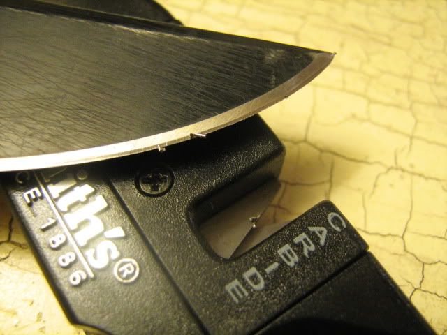

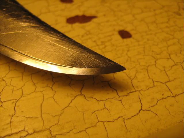

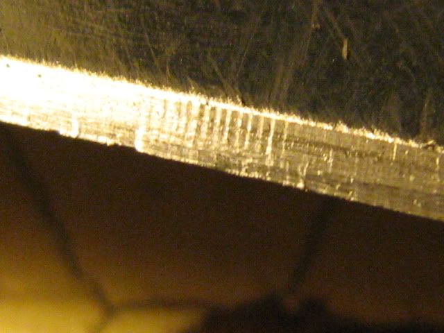

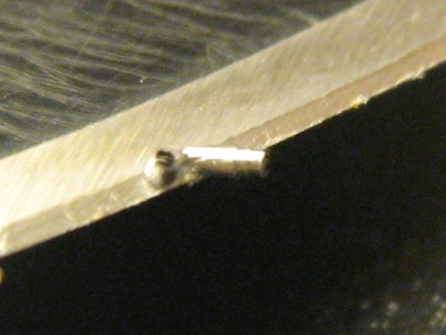

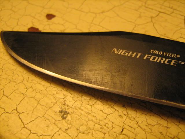

I'm going to buy one and some batteries for my camera, I have a old cold steel folder that uses 440A that I will test it on, I'll take some up-close pictures so we can all see what it really does.
I'll have some 400x pic's up in a bit but after you see these I don't know if its really going to matter.
When using one of these tools one of the biggest problems is that you can not use light pressure. It works like a hand plane does on wood, you must use enough pressure for the carbide teeth to shave away metal. If you use light pressure then it simply does nothing, I tried.
I even put the sharpener in a vice to be better able to hold the blade straight and apply even pressure for the best results. When I started the existing edge was last sharpened using diamond stones and was shaving sharp. Its been a mule for my brother to practice his sharpening skills but was last sharpened by me with a pair of dia-folds just to show a friend their effectiveness.

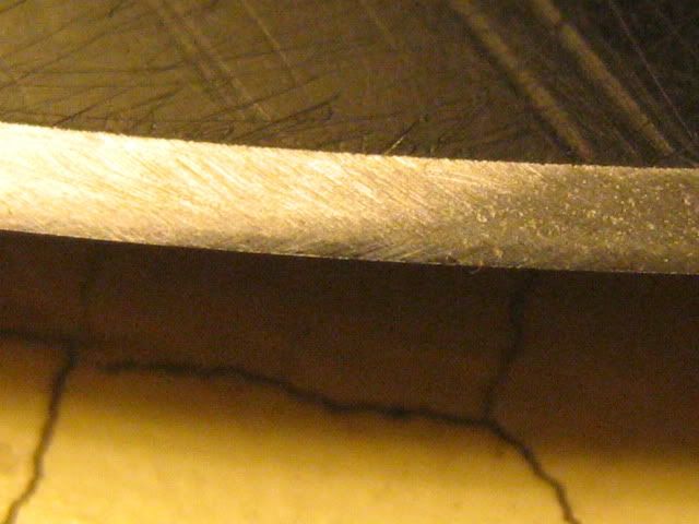

Now on to the horror.
Before
After
Yeah, those images tell the tale.

It would still be better to use a coarse diamond stone, I know he's using it for his beaters but even with the ceramic "V" next to it I could not get the knife shaving sharp. Tell him HF has a cheap set of diamond stones for about the same price as one of these sharpeners, hell, buy it for him and teach him a few points of freehand. At the very worst he would end up with a sharper knife and a new skill, you don't have to be good to get a blade sharp with a coarse diamond.

Comments on the experiment: That's pretty cool to see before and after pictures. I can't figure out what the "bump" on the blade in the 4th picture is though. It almost looks like a thumb stud, but obviously it's not as it's on the edge. Weird.

Anyway, I tried it on a few cheap knifes at home and one not so cheap knife. I got nothing. I haven't used it since. I felt stupid for a while, but now I feel smarter that I know that most of these just don't work with a darn and remove lots of steel in the process; as these pictures show quite vividly!

That thing that looks like a thumb stud is the metal shavings produced by the scraper :eek:
