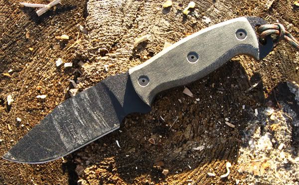

I have had this RC3 for about two years. It was stripped just after I got it as new, after heavy coating wear. I was not gentle on this RC3 by any means. It has seen some tuff use, batoning, field dressing whitetail, fresh & salt water fishing, hiking, camping & the list continues. There have not been any issues with the bare 1095 steel to date. As hard as I am on it, I am just as good with cleaning & wiping it down with mineral oil after each use. I like the blade stripped & it cuts like a monster!
How did you take the coating off? Did you remove the slabs? If so, did the go back on as securely as when they were new?
SS
I removed the coating with a combo of chemical stripper & scraping. I left the coating under the slabs for corrosion protection. The slabs went back on just fine, no issues. There was a very tiny difference in thickness on the edge around the handle between the slabs. It is so small it is almost not worth mentioning...but to be exact I wanted to note it. I also sanded the screw faces as they are stainless and brighten it up a bit.
