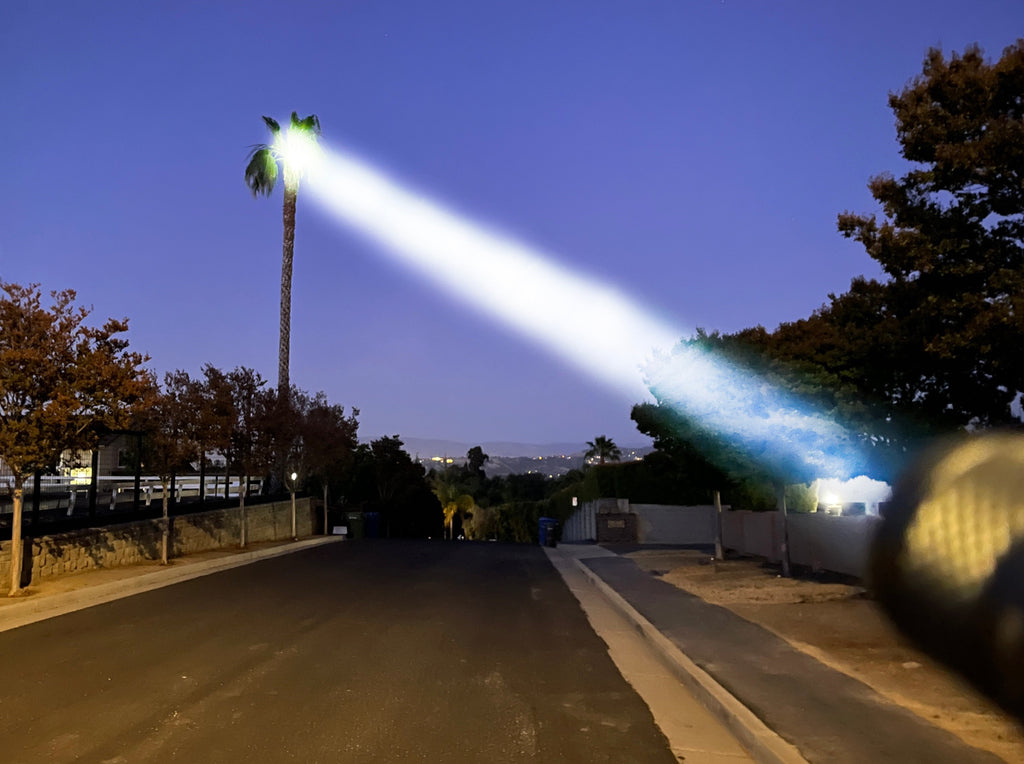

I have the both the small and large LEP from Countycomm. I haven't tested the small since I missed ordering a battery but I will have it sorted in the very near future.
For the big one they say the throw is over a mile. You will need to take binos to see the coyotes at that range.
Photo is from their site, no palm trees here but I can confirm it's alien abduction bright.
Thanks, I looked at those LEP. They are very cool but too extreme in throw Vs spill.
I am looking for something more like 500-1000 meter throw. Some spill would be a good thing. My Olight Warrior X was doing the job but was stolen…and so thinking this time get a little upgrade
