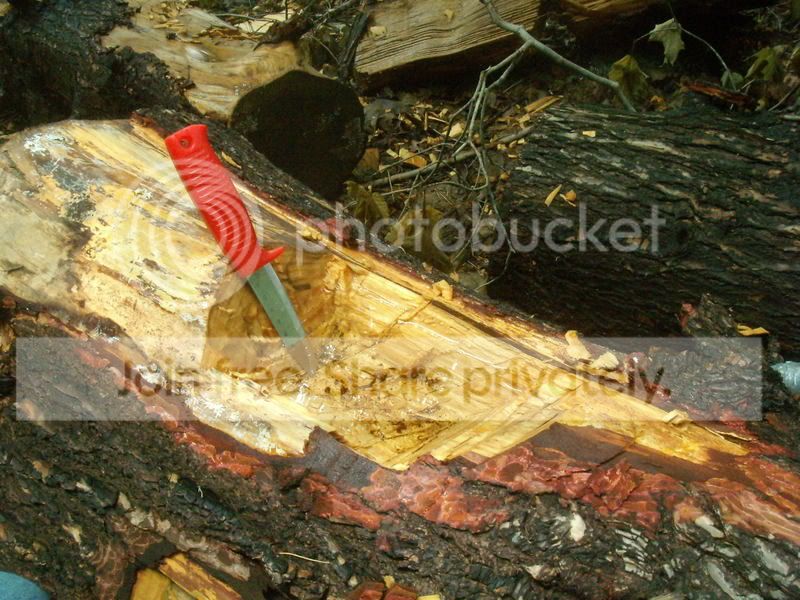

yesterday or the day before i was out playing with my new wetterlings axe, just chopping on some pieces of wood laying around. i started to chop a very undersized notch into a very large log, and as i kept chopping, i realized i had created a nice little container. i brushed the chips out of it and walked away, forgetting about it until this morning. last night and this morning it has been raining pretty hard on and off, and when i walked by the log i noticed it had collected roughly 2 cups of water.
this inspired the thought that a larger version of this could be very handy in a long term survival situation, or if you needed something to focus on to keep from going mad. i suppose with enough determination one could probably make something strongly resembling a canoe with this method. just thought i would outline the basic method, even though its not too complicated.

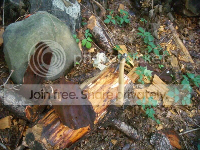

i cut the bark off of the log first, to make it easier to chop cleanly and to make it easier to see what's going on. the bark could be used for other things, like for making a shelter or used as a container of sorts.
next i leveled off the area a bit with some axe cuts and started to cut a notch much like for chopping a log in half...but far undersized.

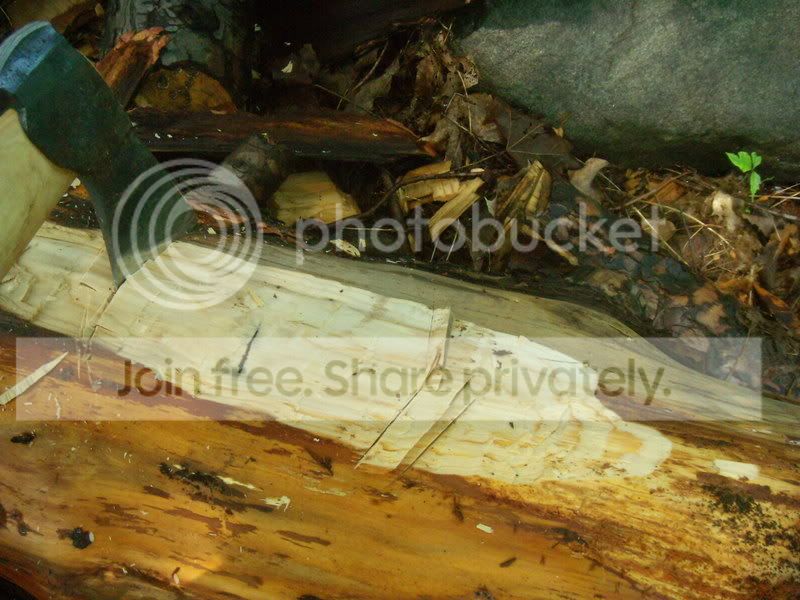

keep chopping at the sides of the notch until you pop out some chips

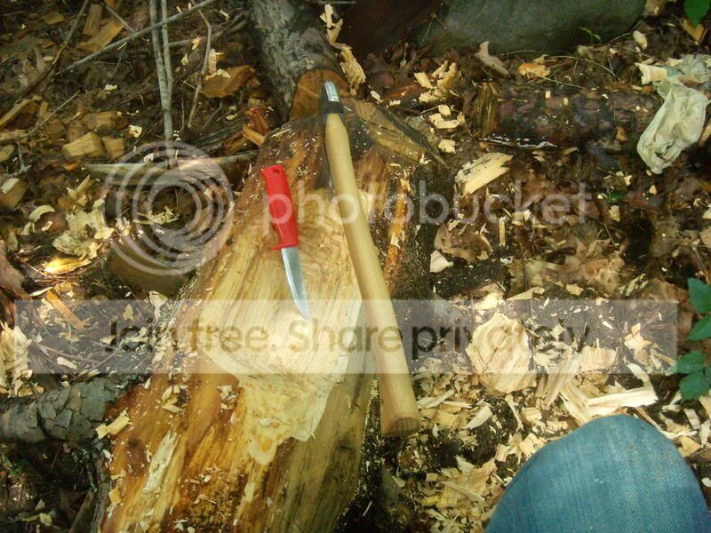

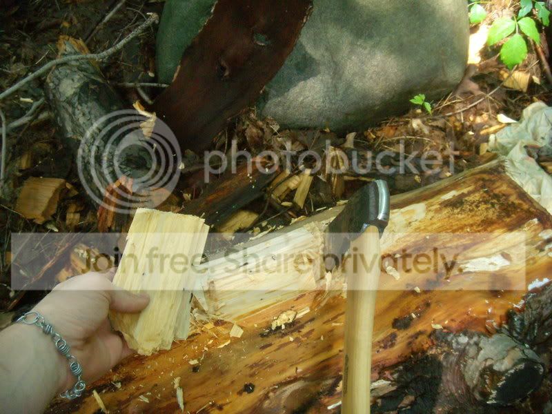

keep going and going until the dish is deep enough and long enough. after you have the basic shape of the dish, you can make it longer by chopping more off of the sides. also, it is good to make some cuts on the short sides of the cup, then make some splitting cuts in the dish to pop out nice big chunks of wood.

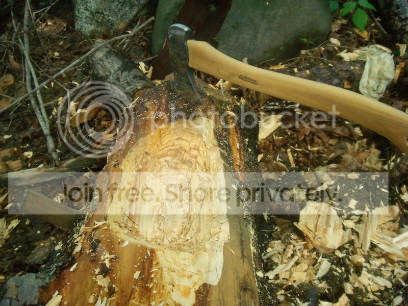

once you are happy with the size and shape, you can use your axe or your knife to smooth it up a bit. don't worry too much about making it totally smooth, unless you are looking to kill time. shown with "viking" model mora for size comparison. this one probably would hold 4-5 cups of water

that's pretty cool simon... sand those out and you have some nice containers...:thumbup:
i think that as i have time here and there i will try enlarging this one to make it bigger and bigger...maybe even large enough to hold a gallon or more.
i was also thinking that it could be made really smooth if i used my gouge.
