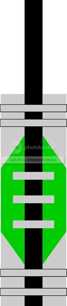

I decided to challenge myself to create a handle with no visible pins and this is what I came up with
Of course, it has pins - 7 of them: Two in each bolster and three 1/8" pins hidden 1/8" deep in the Jade G11. With the mitered (dovetail) bolsters, this handle will stay put for several lifetimes.
The blade is 8" of differentially tempered 3/32 O1.
It has a flat grind with the last 1/8" being convex grind. Then I'll finish sharpening with a V-edge. Right now, the unsharpened edge is at .007
I thought it might be a bit heavy since it has so much stainless hardware, but it weighs in at 10oz, which I think is manageable. The balance point is right at the front bolsters.
There are two areas of concern with this knife:
One is the small area of G11 near the front bolster that is discolored. I'm not sure if I hit it while peening, or what I did. It is not that noticeable, but I know it's there.
The other is the blade finish. I gave it a 600 grit hand rubbed finish before a dunk in FCL and I just can't seem to get a good uniform finish. I know part of it is due to the differential temper, but other than that, I can't figure out why it is so splotchy. It was super clean before I etched it. I'm wondering if my HT may have affected it.
I decided to try something different with the HT. I gave it a dunk in P50 then quickly put it between two ice cold plates of AL until cool. My RC tester says it is between 60-65, which is what I want since I tempered it at 400, but I just wonder if the plates made it cool unevenly?
Overall I am very pleased with the way it turned out, but I need to figure out how to have a better etched finish.

Here is a diagram I just made up to show where the pins are. The pins in the bolsters are all peened. The dovetails keep the G11 from coming off outwardly and the hidden pins keep the G11 from coming off sideways.
Oh, and everything is epoxied with G-Flex as a sealant.

Ok... so..... the pinned G11 scales went on first. Then the front and rear bolsters were peened on.
Right?
That's really well done Jack.
Peter
Right?
Yes, the G11 was set in place and the bolsters were then peened on, all while the epoxy was drying. Very fast and messy work.
