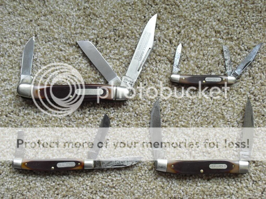

Upper left in this pic is an old 858OT with a messed up spay, that was turned into a stout little Wharncliffe type.
Upper right is an old 108OT that had the sheepsfoot's tip broken off: I worked it from the top down and it looked like new.
Lower left in the pic here is an old 34OT that had the same issues. Broke main & sheepfoot & spay. Main became a sheepfoot/Wharncliffe style, sheepfoot made shorter with a new tip, and spay turned into a screwdriver that fits most of the screws on my Winchester Model 94. They all look nasty, but they're all sharp, have good snap, and I don't mind working them much harder than I will my other traditionals.
Lower right is the 77OT from the previous post.
~Chris
:eek: Definitely thinking sheepfoot! Nasty? No! Loved/Used? Absolutley! The worse for ware my knives are the more I love them. It just shows they have been used like tools as they were intended. Great looking Old Timers brother!
