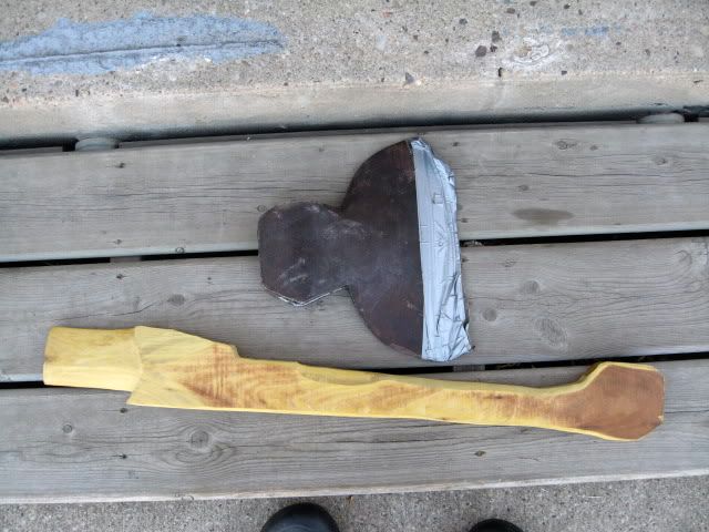

I stopped by to visit Phillip Patton about a year back......gosh Phillip, has it been that long already??......I bought a couple sets of Osage from him, and he picked this up and threw it in my car for good measure.
It's been a good conversation piece, held many a beer, and heard lots of lies since then:thumbup:

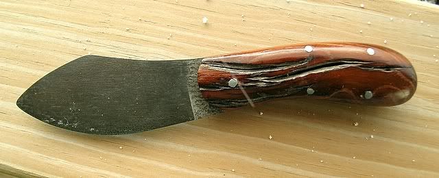

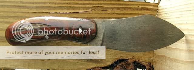

If it were me, I'd save some as blocks for hidden tangs. You can always cut them down into scales later, but it's a lot harder to put them back together
A few hints on working with Osage. Use new, sharp belts at a reasonably low speed. Osage will scorch pretty easily if you don't and when it does it holds the heat a bit and that dark color penetrates a good bit into the wood.
-d
Thanks again for all the responses and pictures.
Tattooed- This piece was cut in 97, shouldn't it be stable enough not to warp after 13 years?
If it were me, I'd save some as blocks for hidden tangs. You can always cut them down into scales later, but it's a lot harder to put them back together![]()
Thanks, didn't know that.
You're welcome.It has more to do with stress being relieved than moisture being lost.
