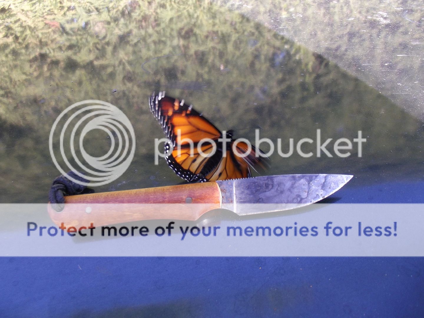

Heres my Bird an trout by Cousin Jack.....good knife

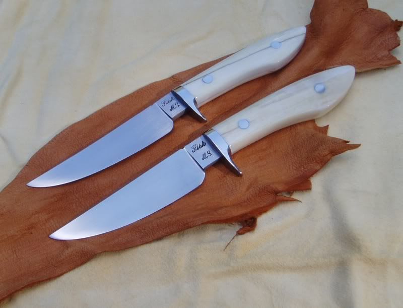

Below is a photo of a Jerry Fisk "Hunting Set" owned or was once owned by a friend.
Bottom, is Jerry's "Sendero" hunting knife which is one of the most recognizable and copied hunting knife designs in existence and
the top is Jerry's "Bird & Trout" version of his Sendero. I believe the photo does a good job showing generally how a Bird & Trout knife differs from
a hunter.

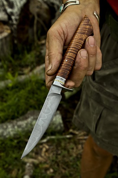

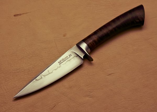

A couple of mine.
The Peregrine
Steel: W2 with hamon
Finish: Regal (hand-sanded)
Overall Length: 9 1/8 inches
Blade Length: 4 1/2 inches
Guard: Stainless steel
Sheath: Leather
The Kestral
Steel: Pattern-welded 1080 & 15n20
Finish: Hand-sanded & etched
Overall Length: 9 1/2 inches
Spine Thickness: 0.141 inches
Handle: Flame grain Koa with coined bronze and filed stainless spacers
