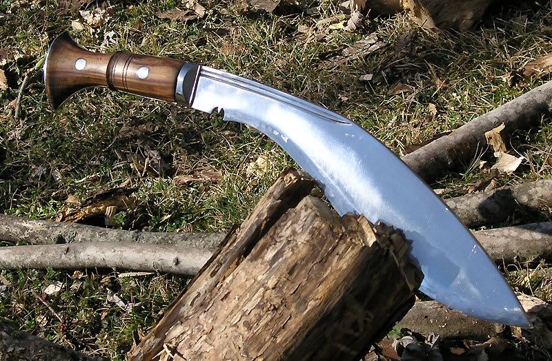

Sgt. Khadka's Chandra Shamsher. Some called it SMASHER.:D
Man you can really tell a khukri was made by the Sarge just by looking at it. BEAUTIFUL!
