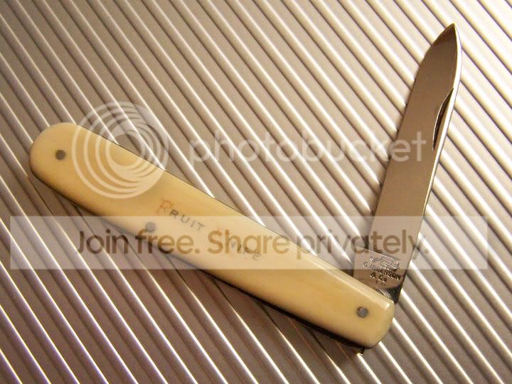

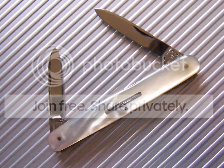

Hi,
I have done a few knife projects, and I am looking to make several slip-joint folders for Christmas this year. I really like the look of some of the old pre-WWII Sheffield folders. I have been finding information on 100 different ways to construct slip-joints, but I don't know which methods would be correct for a Sheffield style knife.
For instance, all of the modern folders use milled liners, thin washers, or a bushing to allow the blade to rotate easily. I don't see anything like that on the old knives. Is it not really needed unless you are just trying to make your knives stand out from the crowd and perform at the highest level?
Also materials. Nickel silver for bolsters liners and pins, or is stainless steel going to be that much better?
I will be using 1084 for the blades (and springs I suppose) so that I can easily heat treat myself, but I am unsure as to what to do for the rest of the materials.
Should I stay away from any of the following for handles; buffalo horn, jigged bone, MOP?
If anyone has any information or links on how to construct an older style slip-joint it would be most helpful.
Below are a couple of pictures of the types of knives I am looking to make.
