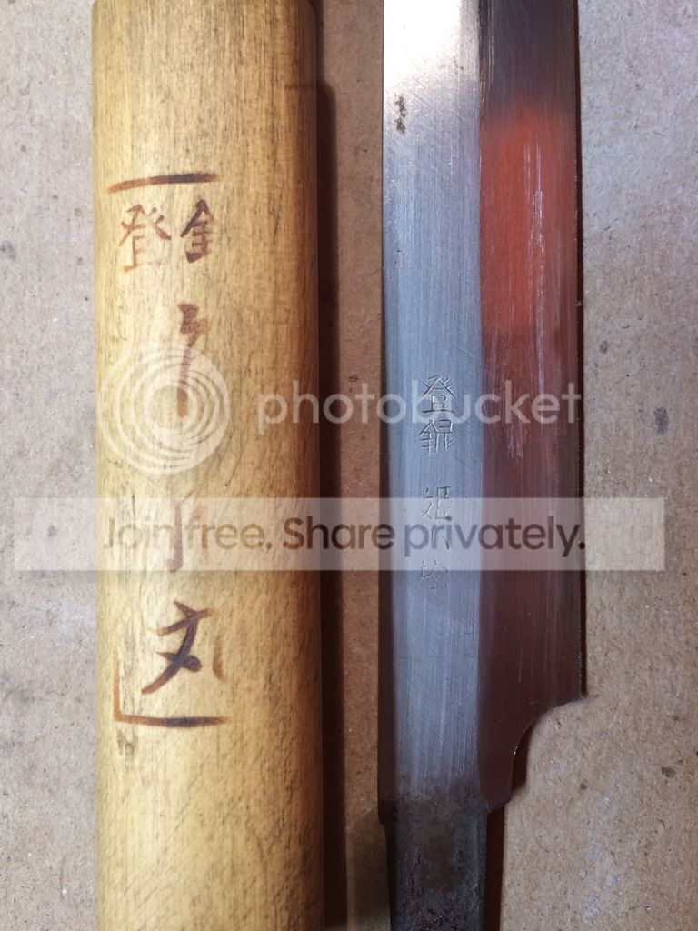

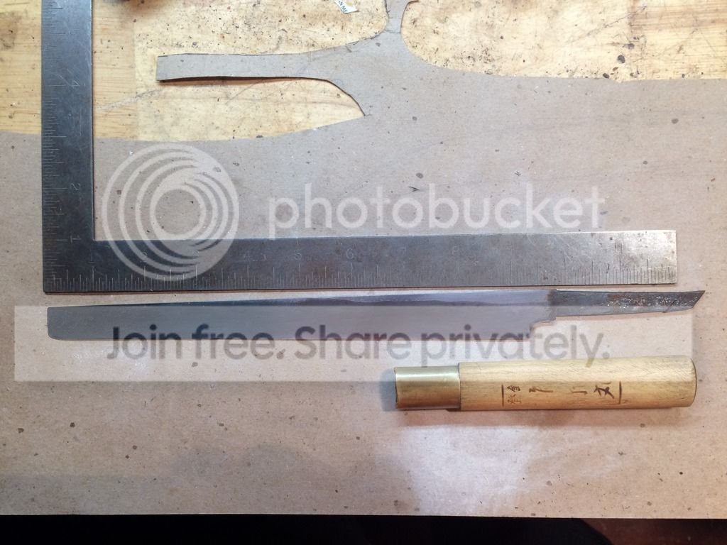

One is a 9 1/2" Takohiki (square tipped sister of a Yanagi ba). This thing was flat out abused. Multiple bends, high and low spots all down the blade, and sharpened on both sides of the blade. I was able to straighten it out by bending and light hammer work. And I flattened the high spots out of the blade but I don't really know if there are any do's and don'ts when it comes to recutting the bevel. I understand that the bevel is supposed to stop at the junction of the tang and should be flat from that point (sori?) to the cutting edge with only the most minute if any micro-bevel.

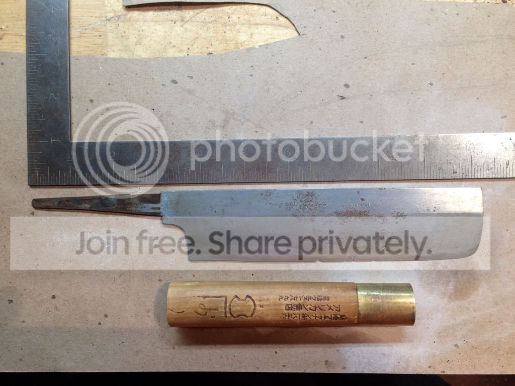

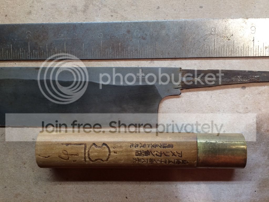

The second is a Usuba (I think) which is in pretty good shape but has a couple chips in the cutting edge and a low spot at the heel (could be intentional, I wouldn't know). It's about 6 1/2" .This knife has a distinct concave back, and convex front. I really don't know how best to go about grinding the chips out and maintaining the convex front. I thought about trying to grind it in the slack belt, but I see that the tooling marks are all running parallel to the blade so I assume there must be a different technique to shaping these.
