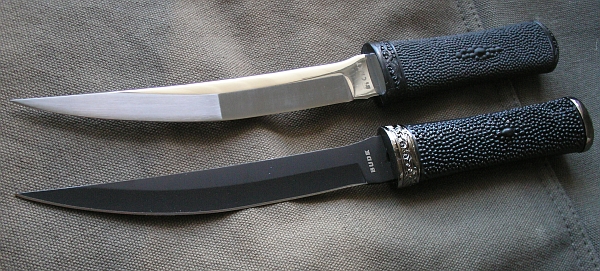

Here's another blade that was designed for the purpose the OP described. It might be hard to believe, but I'm not a huge CRKT fan. But James Williams designs were a definite win for the company. This is the CRKT Hissatsu,and it was designed specifically for military personnel for real CQC:
As mentioned before, everything pointy goes through kevlar. A better bet is to strike where the armor isn't, if possible. Training, training, training. Personally I think you'd be happier with 1084 or 80CrV2-both hold a wicked edge, are extremely tough when ht'd right (differential hardened or differential tempered-the latter is less bendy but not quite so tough). If it's strictly a fighting knife (which the traditional tanto is) the likelihood of breaking a 1/4" blade of any decent carbon steel in that role is really, really small-I have to use a 3' breaker bar to bend test blades to 90 degrees and I am not a lightweight in te breaking things department. I had a Hissatsu at one point and it's a great design, but whatever steel they use dulls on that plastic scabbard instantly-as in on the first draw-and was really just a very attractive tent stake. Kydex dull edges, but this was out of hand.
