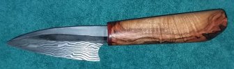

I'm looking for advice on what's the best type of sheath for this 3 1/2" blade:20200526_075503.jpg
I'm planning on making this my personal EDC, and have experience making leather sheaths for my forged blades, but I make mostly kitchen knives, and have only made about 10 hunters/skinners/EDCs in my life. I'd like to try a horizontal carry for this, but would also like to avoid using a metal snap if possible. Avoiding the use of a metal fastener is more important than the horizontal carry, however.
Any suggestions?

If it were me, i would design a pouch style sheath with the knife well over half the handle length inside the sheath. No retention strap would be necessary. This style sheath is not ideal for horizontal carry.
A 45 degree pancake sheath would also be a very good choice and give you at least a little horizontal. In fact, given your criteria, the pancake style would probably be the best choice. Check out Dave's (Horsewright) pancake styles. Many are posted on this very forum. Good luck!

On your blade I'd make sure that heel isn't sharp and then it should work great in a pancake. What problems did ya have first time around on the pancake? Beatimous knife btw, whats the handle wood?
Thanks for the advice, it's not 'sharpened' sharp, but the heel does come to a point. You're saying I'll have to round that? Any suggestions on how much (what size radius?)

Thanks, Dave. The handle is big-leaf maple from the same trees as almost all my other handles, but on this one I wanted to try an un-stabilized piece using boiled linseed oil. Because this was an experiment (and the blade was originally this one: https://bladeforums.com/threads/looking-for-profile-advice.1724694/#post-19706501) is why I'm turning it into my EDC.
Oh I 'd say just round er off some. Otherwise that will eat into your welt every time you draw the knife.
On that other sheath if you make the tabs for the slots stick out further on both sides they'll mold down so it sits flush. Change of pattern.
Would you recommend this instead of what I was thinking, which was to make the top (outside?) piece a little wider to allow it to more fully wrap around the blade more and allow the back (inside?) piece (and slots) stay flatter against the body?
Yeah I would. If those slot tabs stick out further then they will shape over to the shape of your body. They have to be a little longer than the thickness of the handle. They are pretty thick too for their length so that doesn't help either. I will sometimes skive down those tabs so they are thinner too. Helps with break in. I also arrange the welt so its not in the tab just in the seam where it needs to be and sive the outside edge down to zero.
