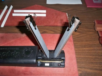

I've also tried sandpaper and I prefer a DMT stone for heavy metal removal or reshaping. A DMT coarse stone is what I use for that before I go to the grey Sharpmaker rods. I also have diamond SM rods, but I still use the DMT if I'm doing a lot of work.
Sandpaper attached to the rods works great also. Heck, I've even propped a DMT bench stone up against the Spyderco rods before to re-profile. Worked fine.

I was take Congresstools Moldmaster stones. Great stones for re profile. Using 120,240 and 400 grid. After that Sharpmaker stones will do the rest.
I will use the picture from web to demonstrate how I did it.
