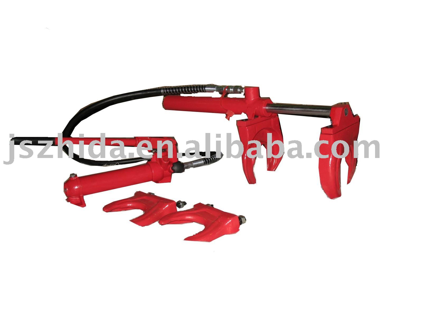

A little story about springs... Our 50lb. Fairbanks, an "A", has a small spring 'cause it's a small hammer. One of our efforts to compress the spring was with two 3/4" pipe clamps. Neither the thread-type on the adjusting end or the length of the turning handle are highly conducive to moving high resistance... still, person would have thought they should work... person was wrong. Bent both 3/4" pipes. The spring used the short lever arm from the jaw pads to the pipe centerline and turned both into very-curved... =]
So, what's a person going to do with the spring out of a 250lb. hammer, or 500 pounder?

I think it's important to keep the force inline instead of off to the side.
I'd first make up something like a 2 arm bearing puller with an acme thread
There are all kinds of attachments you can get or make to fit a hydraulic power pack jack
For example, but you can go bigger and make it so you keep the force inline instead of off to the side.
