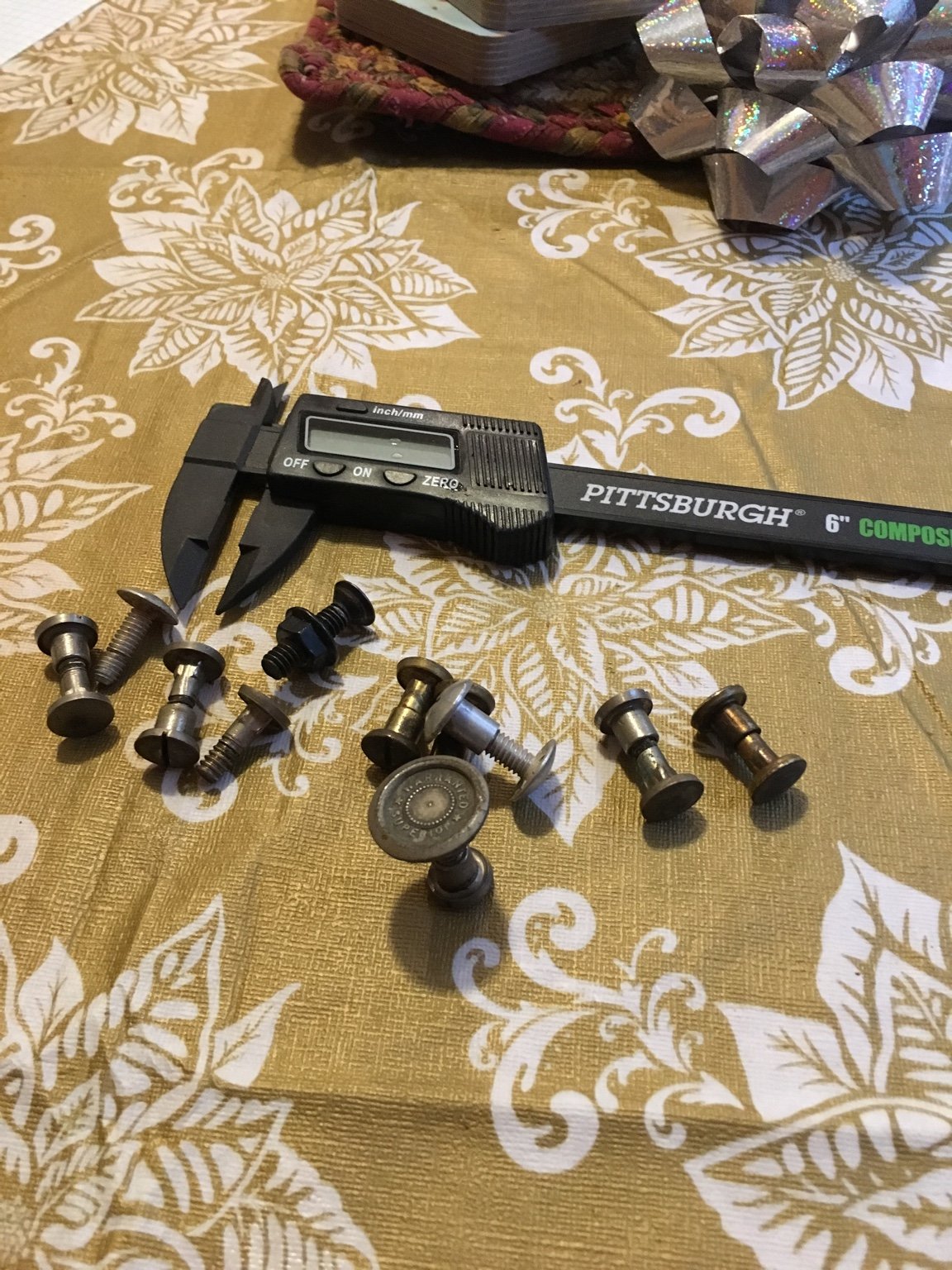

Pivot size is totally up to you. I started with 3/16 pivots with 1/8th stop pins, but I have also used 3/16 stop pins.
I buy inexpensive reamers on eBay and at the speed I make knives, they last a long time. (I'm slow)
I've recently started tooling up for 1/4" as well but only because I had someone request 1/4". I really like the versatility of 3/16". Most of the pivots and stop pins I've bought have been from AKS.
