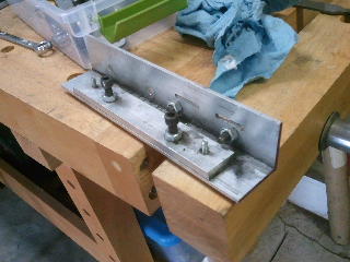

But, i've made a jig using aluminum angle. Holes to attach the blade and screws in the base to dial in the bevel angle.
Going to try posting a pic from my phone. If it dosent work, i'll post it later.
pic now added
This can be used for either flat or hollow grind. Depends on where your jig is mounted on your grinder.

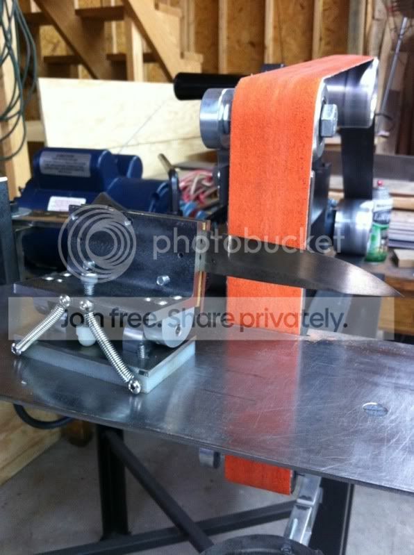

jbblount, have you tried a tilting table and two pieces of micarta to hold the knife. It's far more easy to control. Frank
Yea Frank I've tried just about everything. I really like my jig. It's smooth, solid and easily adjusted.
