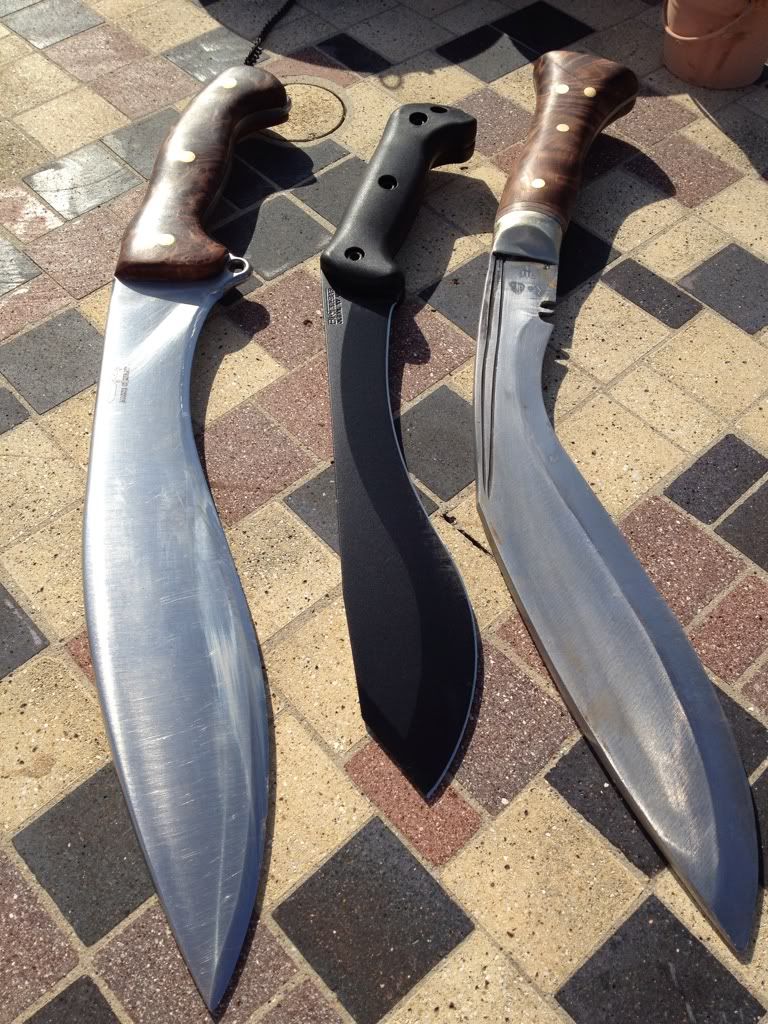

One factor in handles sliding is vertical (belly to spine) shape - if it only tapers and doesn't have much of a bird's beak at the heel, it's easy for the handle to pry apart the weak lower fingers and slip forward. Also if the spine is too straight relative to the blade, it is easier to slip straight forward through the fingers. If it is curved more (like a kukri or Becker machax) it has to rotate against the hand to escape, not so easy, which allows more power to transfer from the hand/arm into the object being struck.
GSO-10 & Rodent 9 (my image)
A couple kukri's and machax (pulled from the Yard)
