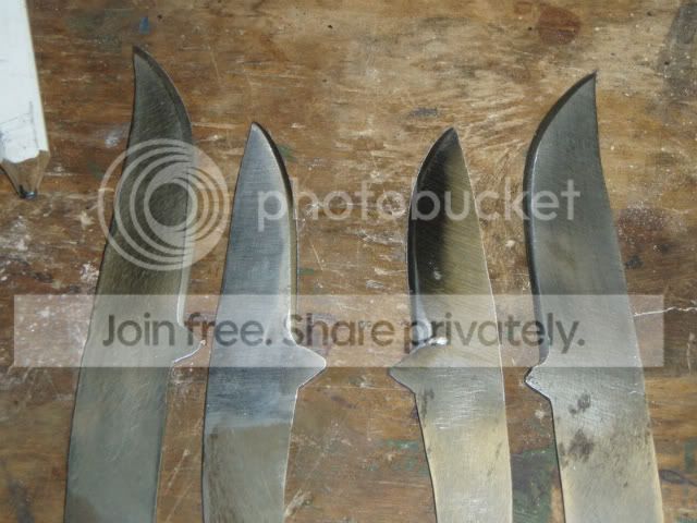

I have tried my own pattern, cut them out, but cutting my bevel is what is kicking my tail. Ive tried a belt sander, grinder, etc and i just cannot seem to get it right.
here are the 2 blanks i came up with on my first attempt. I want these to be a college graduation present to my brother but i dont have the time to start over now.
Jantz and Texas Knifemakers Supply would be my top choices; they both have a wide selection of blades and you can get them in 440C. That's about the best steel you're going to get with kit blades.
The ones you cut look good, Whats wrong with them? I used only files for a lot of years to cut the bevels. On a 4" x 1/8" blade it only takes me around 2 hours to put the bevels in. Good, sharp, files are the key.

Go for the self done knife....what you started with...1st attempt....looks like a real fine start.....
Don't go for unmarked blanks.....cut/grind your own......you are not without talent....
thanks fellas. Just one more ??? for ya. Is there some sort of file guide i can use to keep the bevel consistant? I cooled off a bit and looked them over and they dont look too bad. Still need to work on the bevel but other than that, just need to finish that up and slap a few scales on.

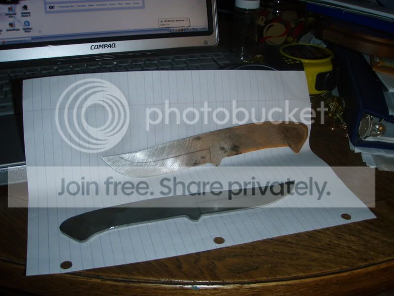

Well i took a jab at it again and i am very happy i did. Here is what i came up with.
I used alot of water to keep the blades cool while grinding-the flash changed the blade colors on the right-and went slow and checked often. I do have one question though, I want to heat the handles with a torch to soften the steel so i can drill a hole easier. Will this affect the blade itself or just where i heat up? These are cut from circle saw blades w/o carbide teeth, its hard steel.
