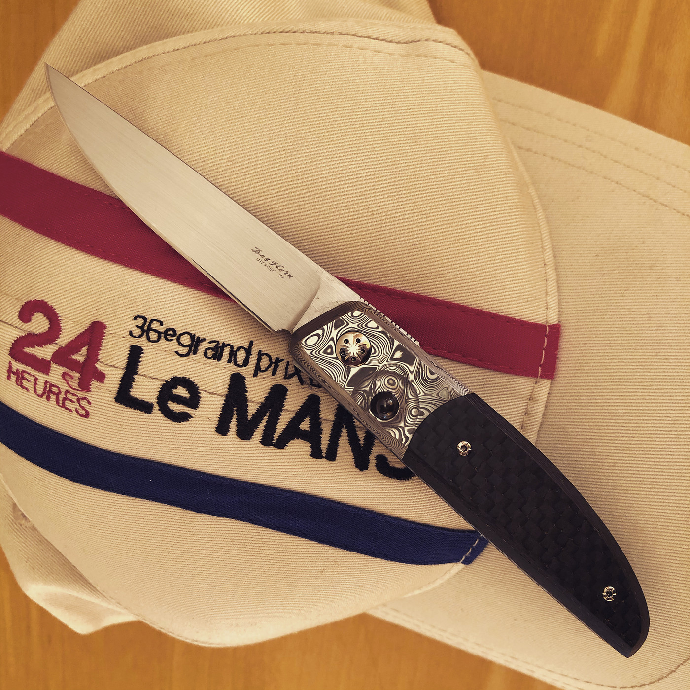

As stated Des Horn has used it extensively and probably still has some stock. I'm happy to put you in touch with him if you like. PM me.
One of mine.........
Beautiful blade!
I reached out to him through the contact form on his website. If I don't hear back I'll let you know!
