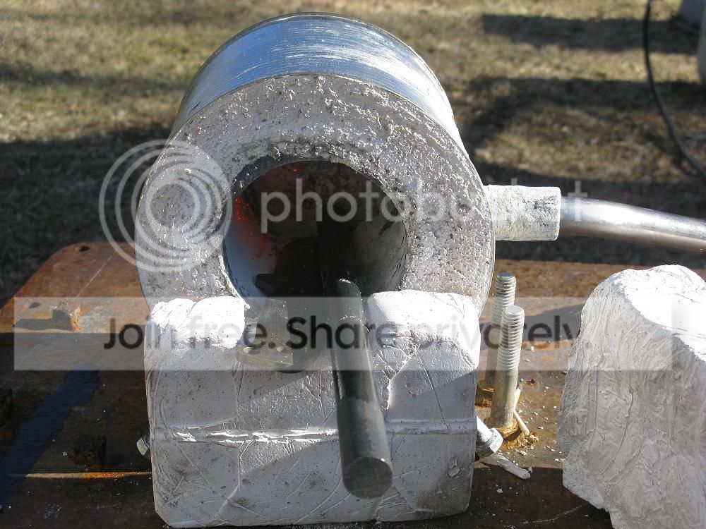

Nice job with the Hamon! I use a metal paint can also and here is my simple coffee can forge. I did the heat treating today and It seemed to go well. I am doing my second temper now. Hopefully soon I will have my first finished knife within the next week.
