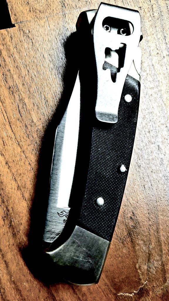

Hey guys, is there someone around here that's experienced in tapping bolsters to add a pocket clip? I have a Buck 112 elite auto I want to add a pocket clip to (don't crucify me, belt sheaths aren't my jam.) I really love the knife but I'm never carry it because it falls sideways in my pocket. Any recommendations would be awesome.
Do you have a clip in mind? You cover shipping and I'd do this for you free. I was a job shop machinist for a couple decades so I've got a little experience. It's pretty easy to drill and tap holes. You might well be able to handle it yourself.
That would be really cool. I have a Lynch deep carry clip I was thinking would work. Do you have an email where we could make a plan?

I actually just got it done. Turns out the #2-56 tap that I thought I had was actually a #2-64, so had to order a tap. Which apparently got lost in the mail and took two weeks to arrive. He just got it back yesterday. He mentioned that he was going to post some photos of the finished product but doesn't look like he got around to it yet.

Yep! E eKretz just finished it up. It looks absolutely amazing. I had him take the OEM clip off the 112 slim and put it on my 112 auto.
https://i.imgur.com/DKccv6z.jpg
https://i.imgur.com/uRg6IZe.jpg
https://i.imgur.com/P3HV2h0.jpg
https://i.imgur.com/Bk3T2bl.jpg

Here are a couple more shots since his didn't post on the page. These are just a couple I sent him while we were waiting for the tap and after it finally got here.
