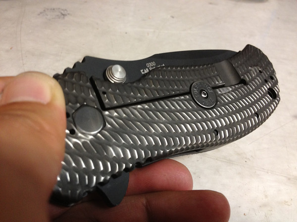

I finally got my knife and took a bench grinder to it. I took the coating off on just the peaks of the 3d scales.
Next I will attempt to flame it and see what happens
You wont get much of a result from that, I spent 4 hours removing DLC and doing a high polish because I tried when mine was just like yours and I was miserable with the result.
