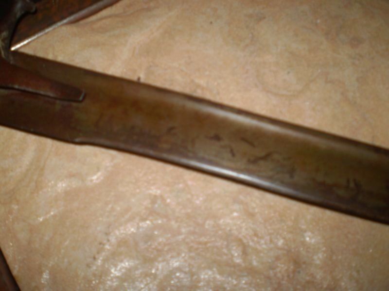

I did some minor polishing then cleaned it with soap, windex and lighter fluid. I tried etching with diluted FeCL as well as diet coke. I don't see any wootz pattern but I do see evidence of lamination. You can see it mostly in the spine. I need to scrub off the yellowing from the etchant but you get the idea.
This one's of the blade itself after etching.

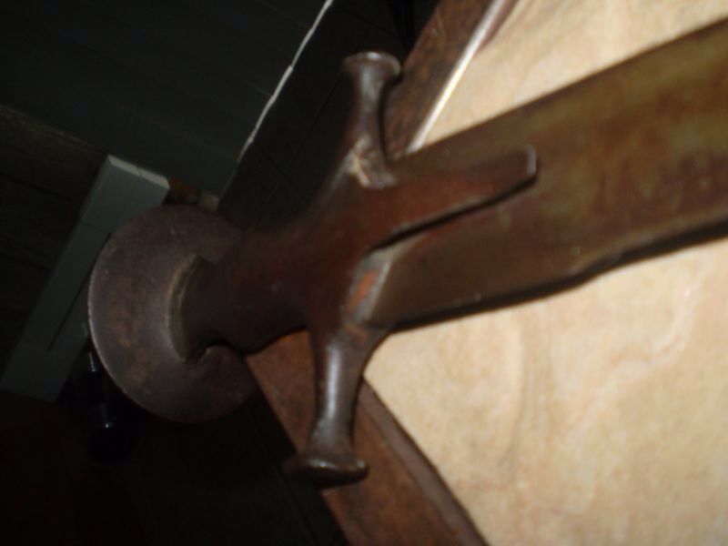

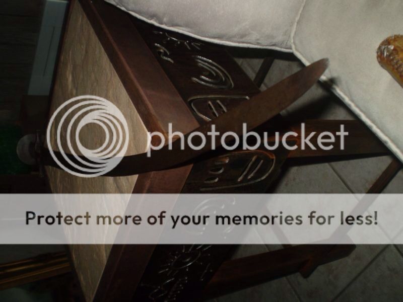

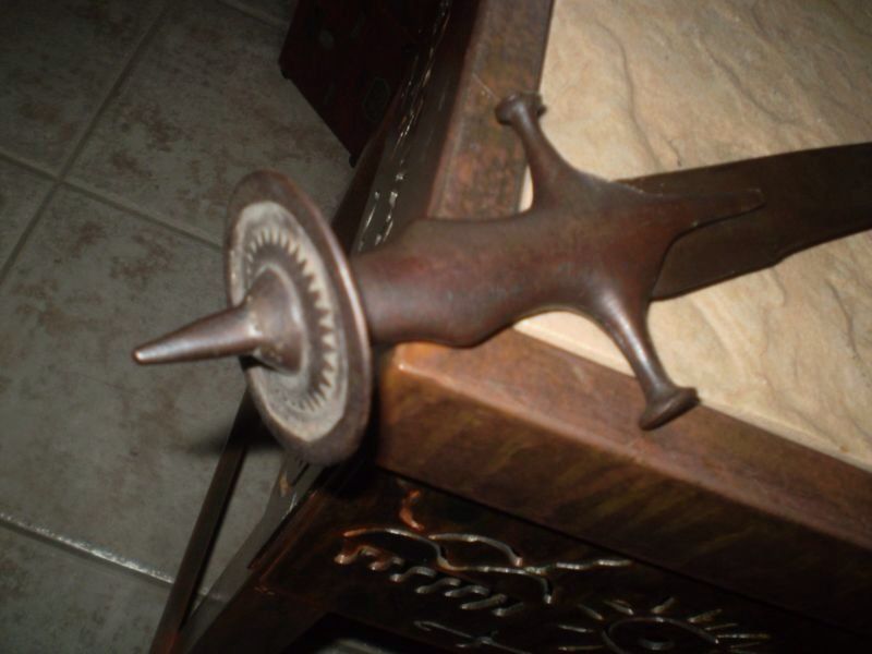

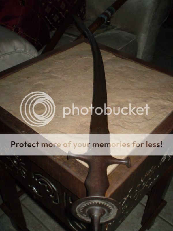

Very cool, I hope my offer will get accepted on the tulwar I posted, I put down 125, with the 21 shipping it'll bring me right under my 150 limit.
The pics are blurry but it almost looks like the blade's hollow ground like a euro saber. But on the other hand it has a hatchet tip and a large ricasso so I guess it's probably Indian
I think the large ricasso is a result of repeated sharpening-can't get the right angle up near the hilt because of the langets. Could still be a euro blade, but my gut says Indian.
One word of advice: there are a LOT of tourist tulwars on ebay. They're usually easy to spot though. The blade's usually have MADE IN INDIA on one side and some sanskrit on the other. They almost always have a bolt at the tip of the hilt. They usually come with a scabbard made from fake red or blue velvet like material.
