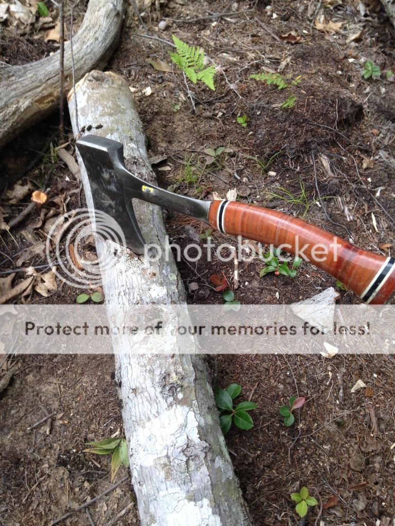

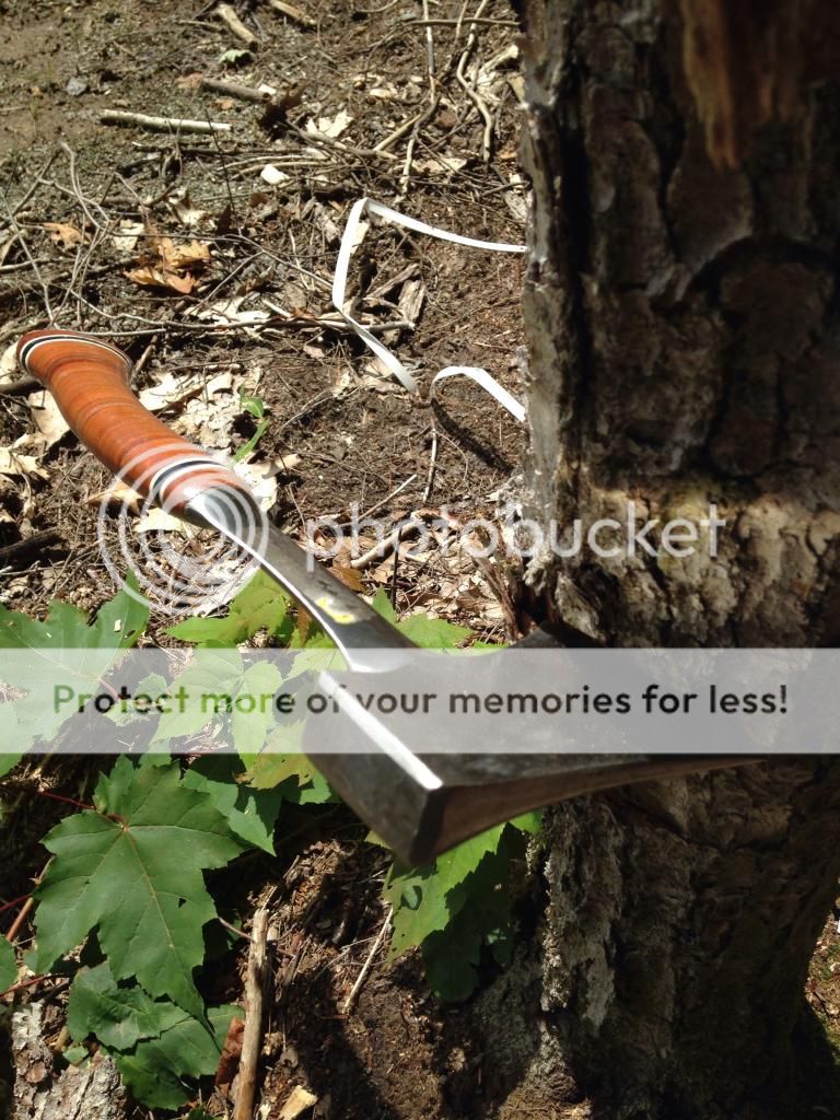

I would definitely recommend the Estwing Sportsman axe, one solid piece of forged steel, it will last many lifetimes, I love mine

My grandkids (not yet born) will use my Estwing. I don't know how it could be busted.
One of the questions to consider, splitting or cutting? IME, the Estwing is the latter, not the former. Mine stays in the barn for trimming branches and (don't tell anyone) grubbing out roots. The thin tapered blade is a decent cutter.
It no longer goes car camping though, as it tends to bind worse than more traditionally shaped hatchets when splitting firewood into kindling. At least for me. I'm not the best with a hatchet.

I believe it is 1055 carbon steel, I convex mine not sure if that helps with the splitting, can grip the head in palm of hand and do more detail cuts.
