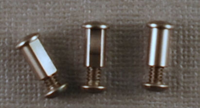

I have a loose blade on my Salt and it has one of those torx screws which has the dome shape on the other side.
The problem is when I try to tighten it the other side just spins along with it.. thus it cannot be tightened unless something is holding the other side (dome side) in place.
Are there any tools or tricks to holding the other side so I can tighten the pivot?
I found this pic of the internet.. but I don't know if the Salts has the flat side as in the pic above. Which it would seen to would keep it from turning.
Any suggestions?

Normally, those screws are used in conjunction with D shaped holes in the handle/liner so that the domed part simply cannot turn. It's possible that the holes in you Salt's handle were round from the git-go, since it was originally designed to use rivets. It's also possible that you rounded them out attempting to tighten the screw. Either way, I've heard that opening the blade and side-loading it will put enough pressure on the domed headed outer part to allow the screw to be loosened or tightened. However, there's also a good possibility that the screw is already as tight as it can be. As for the "why", Sal has said that it's done to make manufacturing easier, not for user adjustments. Although it's probably not what you want to hear, your best bet might be to send it back to Spyderco for repair.
EDITED TO ADD: Just for the record, those screws in the photo are from an FRN UKPK of mine. Its handle does have D shaped holes but, unlike the Salt, it was designed to use those fittings.

The Deacons's suggestion might be enough to so the trick. Have you tried carefully heating the pivot with a soldering iron? Just watch that you don't melt the frn.
A wide rubber band or the like pushed on the domed part of the pivot may give you enough traction to hold it. Its also sometimes helpful to give the screw a sharp, quick turn to break the loctite.

This did the Trick. Thanks Deacon! I was able to loosen the screw. Cleaned it off and tightened it and now there is no blade play whatsoever.
I placed blade sideways against a wood table. I pushed sideways and this held the opposite screw tight enough to where I got it loose . The excertion on the pivot by the blade held it until I could break the locktite.
