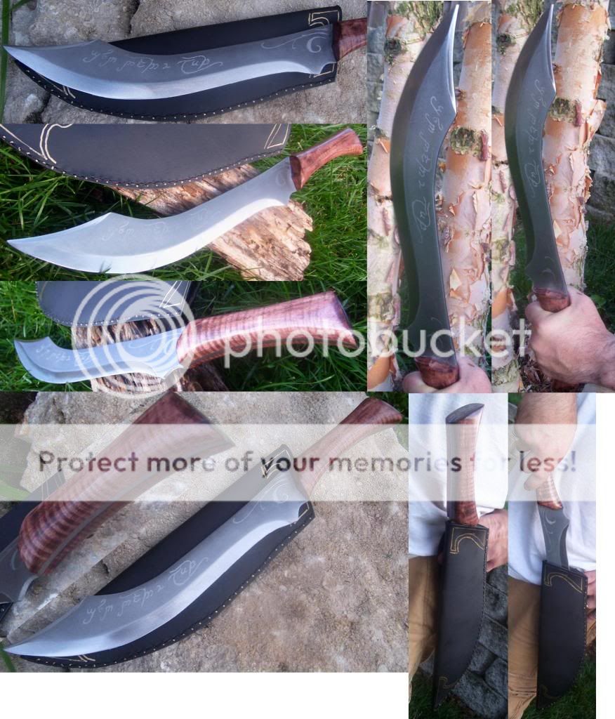

Did this one for a customer this week and wanted to show it off. I liked the style.
Also released a youtube video on it:
http://www.youtube.com/watch?v=H-O0sWN0QSw
Shop Details:
Saw Blade Steel was cut out and Normalized @ 1500 degrees until non magnetic, three times, to remove stresses and align crystals. Heat Hardened until blade became nonmagnetic, then quenched in 125 degree quality oil. Tempered the blade to a straw hardness @ 425 degrees for 1 hour, letting it air cool and repeating once more. Sword was file tested and is shown to be very hard.
Measurements:
Total Length = 20“
Blade Length = 13 ¾ “
Blade Width = 2 1/8 “
Blade Thickness = 3/16 “
Handle Length = 6 ¼ ”
Handle Width = 1 ¼ “
Handle: Tiger Maple Wood
Weight = 1 lb 3 oz
Hand stitched Leather Sheath
What are the specs for it? Top secret? J/K :D It's one impressive piece of work :) Nice job, Archer!:thumbup:
Ooops, I knew I was forgetting something :D
I added the specs.
Thanks for the good words! Chris
